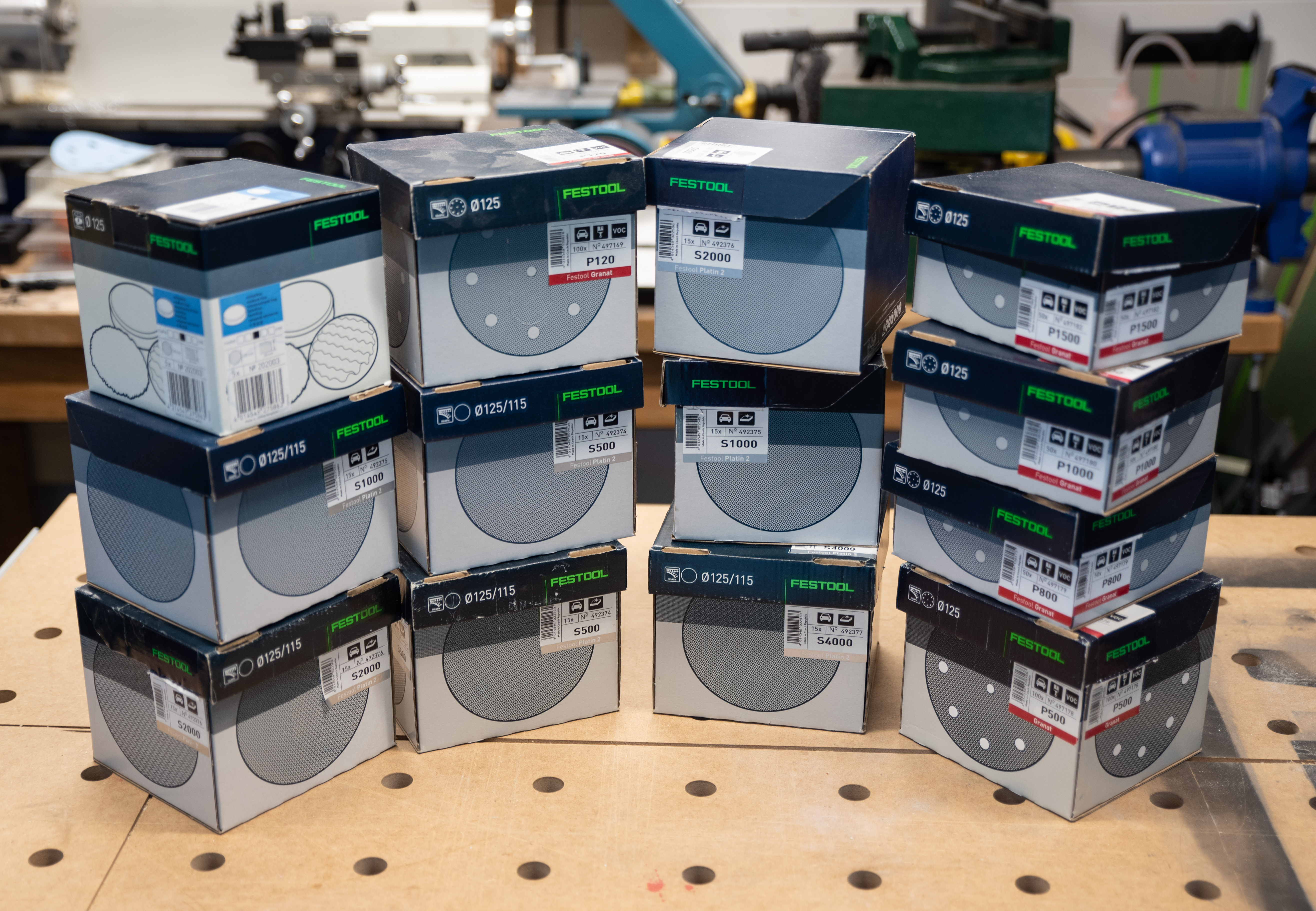

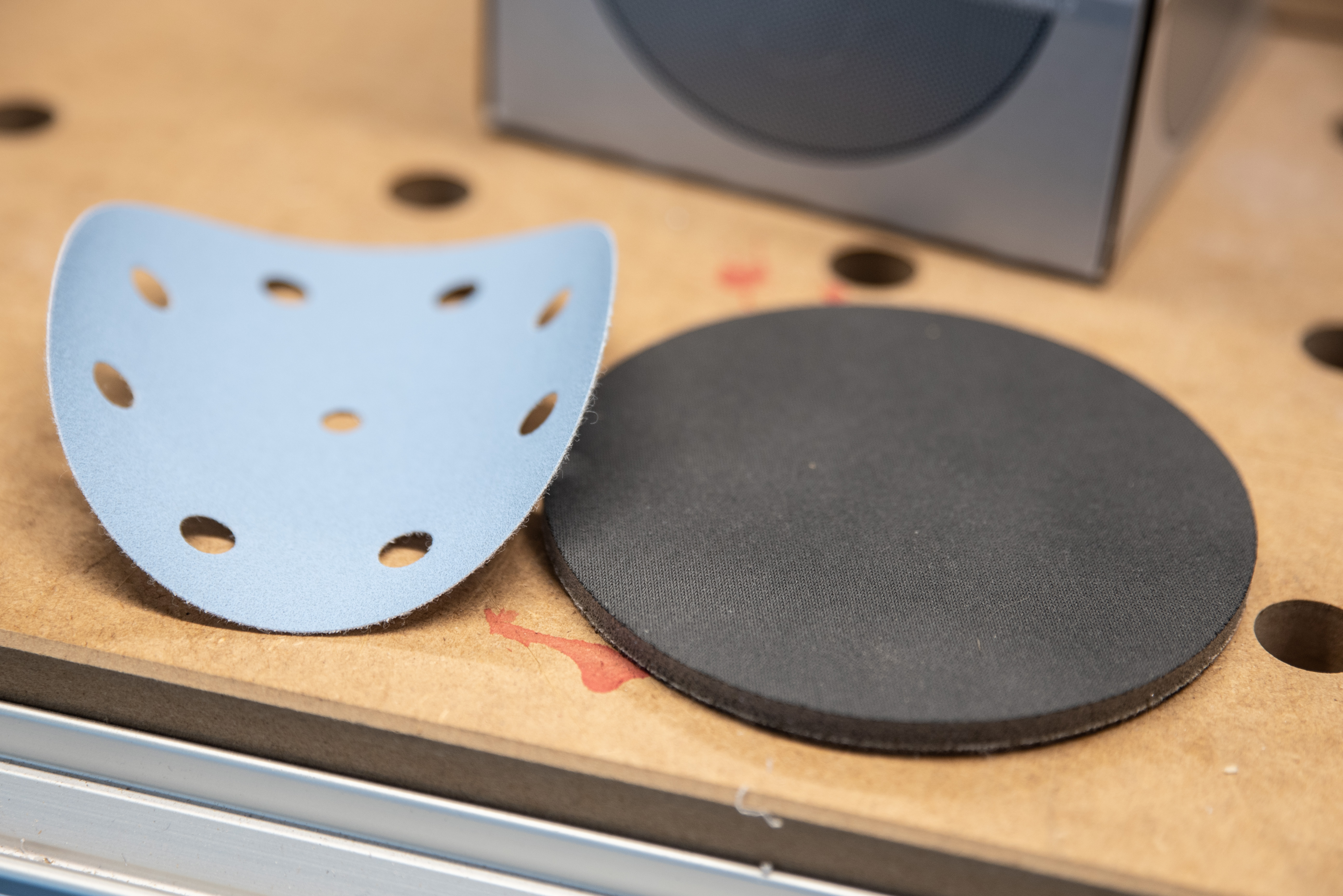

This is the exciting part for me, as this mod is fantastically simple. All that it requires are soft pads in 500 and optionally 1000 grit variants. If you're not accustomed to this sort of sanding pad, be sure to check out our Toolbox article on machine sanding where I highlight some of their uses and benefits. In essence these sanding pads are designed for conforming to curved surfaces; they're frequently used for polishing soft surfaces like plastics, lacquers, and resins. If you happen to do automotive body work or are into tenpin bowling, you'll be accustomed to seeing these around.
Click to enlarge
Click to enlarge
The ones I use are Festool's Platin II discs; a very good alternative is Mirka Abralon, which also conveniently is often sold in smaller packs. All you need to do is take a 500 grit pad, then gently sand down the tube. I like to begin by dragging along the length of the tube, and then doing a circular motion to even out the sanding pattern. If you can still see some faint marks from the 500 grit pad, lightly go over the surface with the 1000 grit one and all should be smooth.
Click to enlarge
Why is it important to use the soft pads? Well, it's not 100 percent essential actually, but it just makes the process much quicker and more reliable, especially around corners. It's very much possible to use standard high grit papers for this, but it takes a fair bit longer to achieve the same level of finish. Any scratches present on the surface will come out very clearly once the coolant flows through, so being even is really important.
