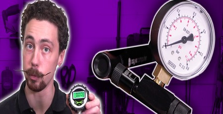

The traditional method works well enough, but there's another popular technique, which is using air pressure to test whether the loop is properly sealed. A handy product for this is the Dr Drop from Aquacomputer, but you can always make one yourself too. The Dr Drop is essentially a little manifold connected to a manometer and a small bicycle pump. The idea is that you connect the Dr Drop to your loop or the component you want to test then pump air into the system. If the loop is able to hold pressure, then it should in theory be watertight too.
Like with traditional testing, you want to give it a bit of time (although not too long, as the Dr Drop isn't completely airtight itself, meaning you may get false results). You also don't want to over-pressurise the system. Most components will only be rated to 0.5-0.6 bar, so that's the range you should stick to. If your system can remain at a constant 0.5 bar for 15-30 minutes, then there's a good chance it's going to be watertight.
Aside from being very quick, the handy thing about this method is the flexibility it has. I make a lot of acrylic distribution panels, and testing those outside of their intended use case with real liquid can be a serious pain. Similarly, you can quickly test individual parts like water blocks or radiators using this technique. If you have a particularly complex loop going on, air testing can be a huge time saver, as draining a large system can take a while. To aid in spotting potential leaks, you can rub a little soapy water around fittings or block terminals, that way you will be able to see air escaping by bubbles forming.
