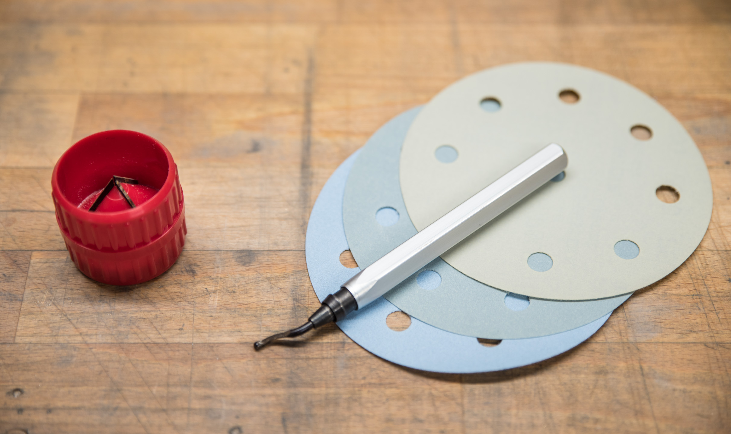

Working our way around, we have a heat gun, some dish soap, a silicon bending cord, a ratchet tubing cutter, sand paper, and two deburring tools. The red kind on the left is the one you'll commonly find included in kits or cheaply online. They work well enough, but I find they can leave a rough edge sometimes. Personally, I like using a rotating blade-type deburring tool, which can be found cheaply on Amazon and similar, along with some sand paper. They do the same job; the left tool will be quicker, the right-hand tool set will leave a cleaner result.

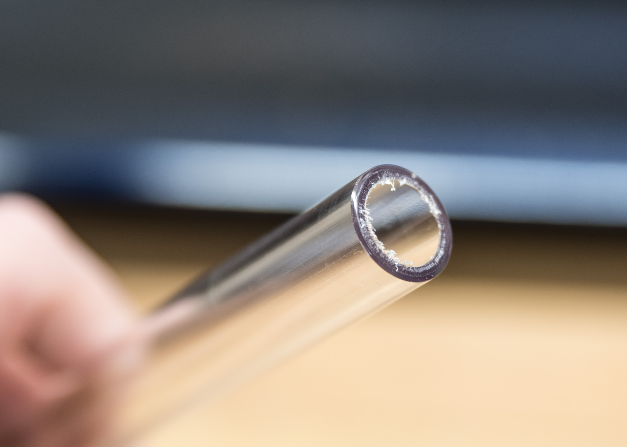

You'll notice, however, that the end is rather messy. We need to clean this up so as not to damage the fittings. The vast majority of fittings make use of O-rings that compress around the outside of the tube, so if the end is messy, there is a chance it can damage them when you insert the tube, compromising the seal.

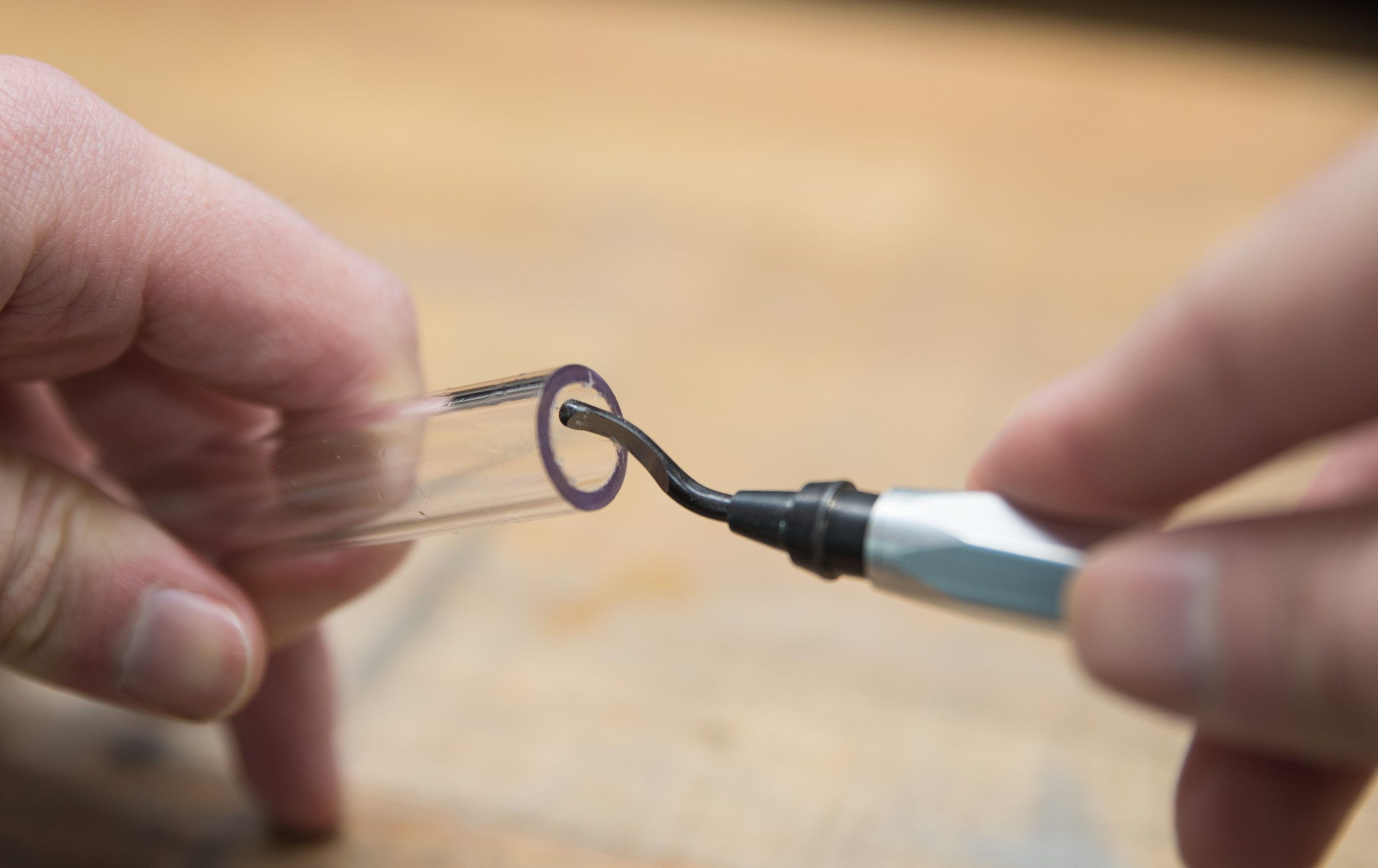

To accomplish this, first I like to wet the ends of the tube, as this helps to achieve a smoother chamfer. We're going to want an edge that won't catch on the o-rings later, keeping them healthy.

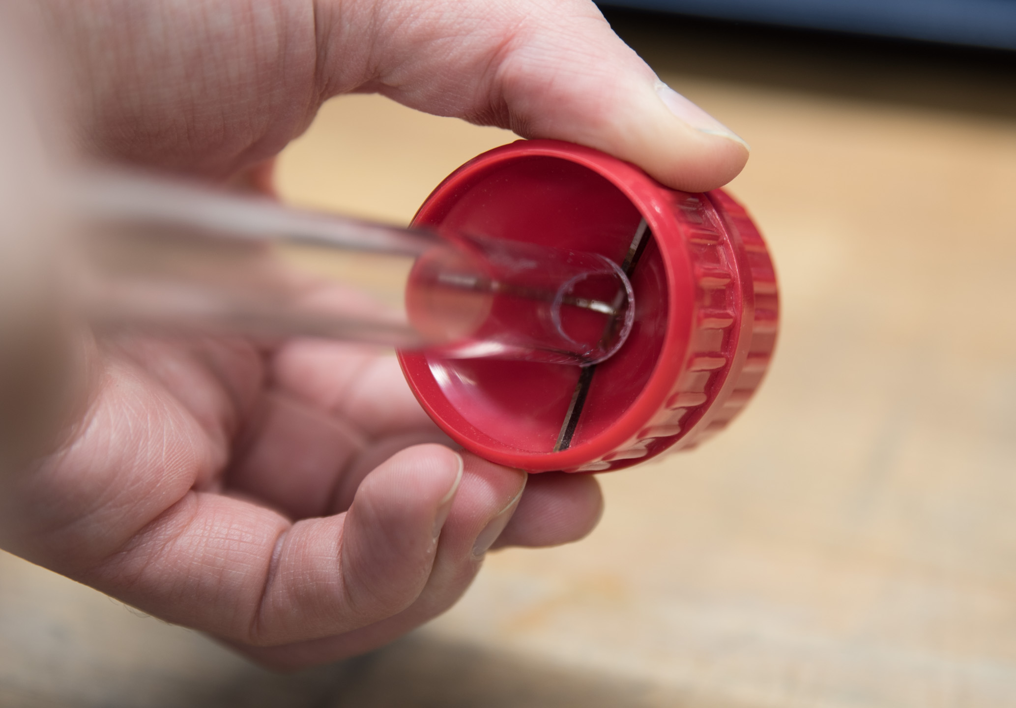

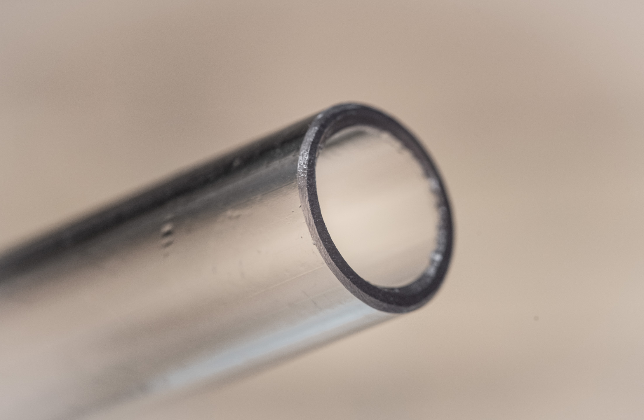

Carefully spin the chamfer tool; it will cut into the edge of the tubing and remove the burrs to leave a chamfered edge. With PETG, this can be a bit of a pain, as it has a tendency to stick, so it may take a few attempts to get a clean cut. An alternative is to use a deburring tool on the inside of the tube and some sandpaper on the outside. It takes a bit longer, but you get a better result. I prefer that method for said reason, but both will work fine.
Our tube is now prepared; it's off to bend it!
