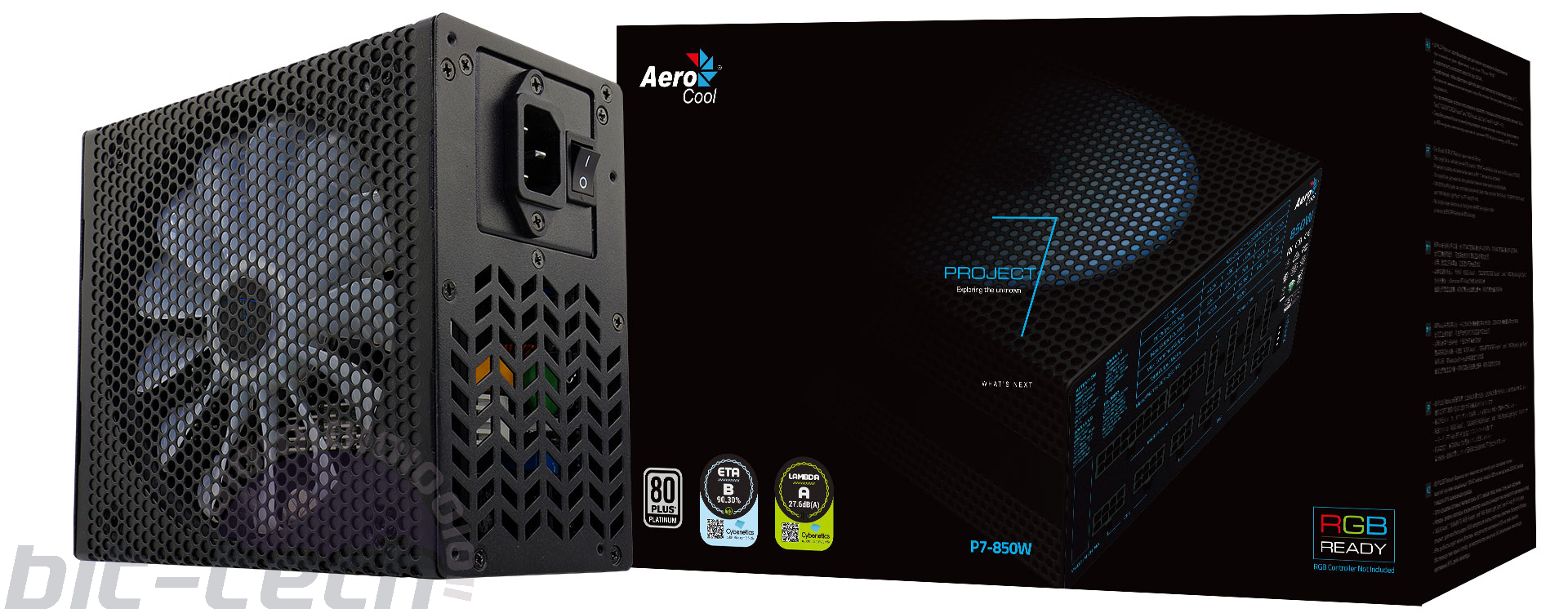

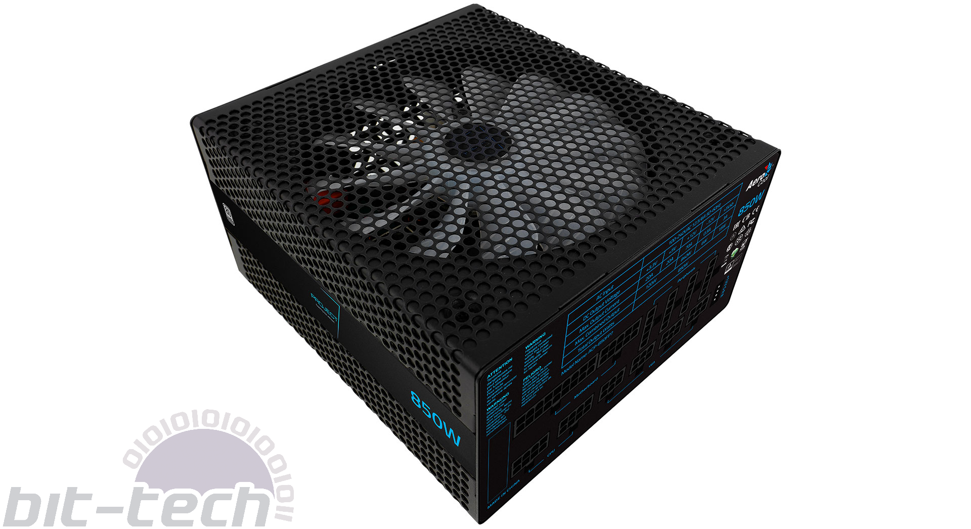

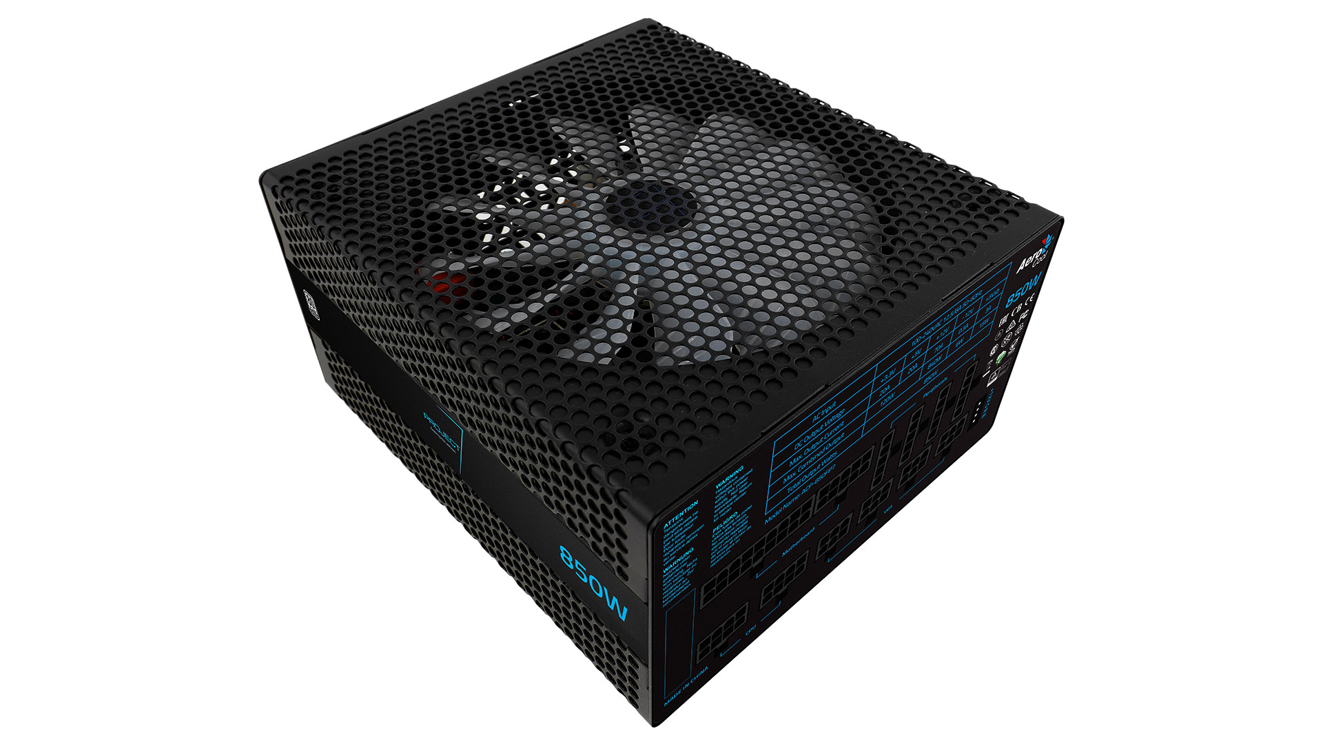

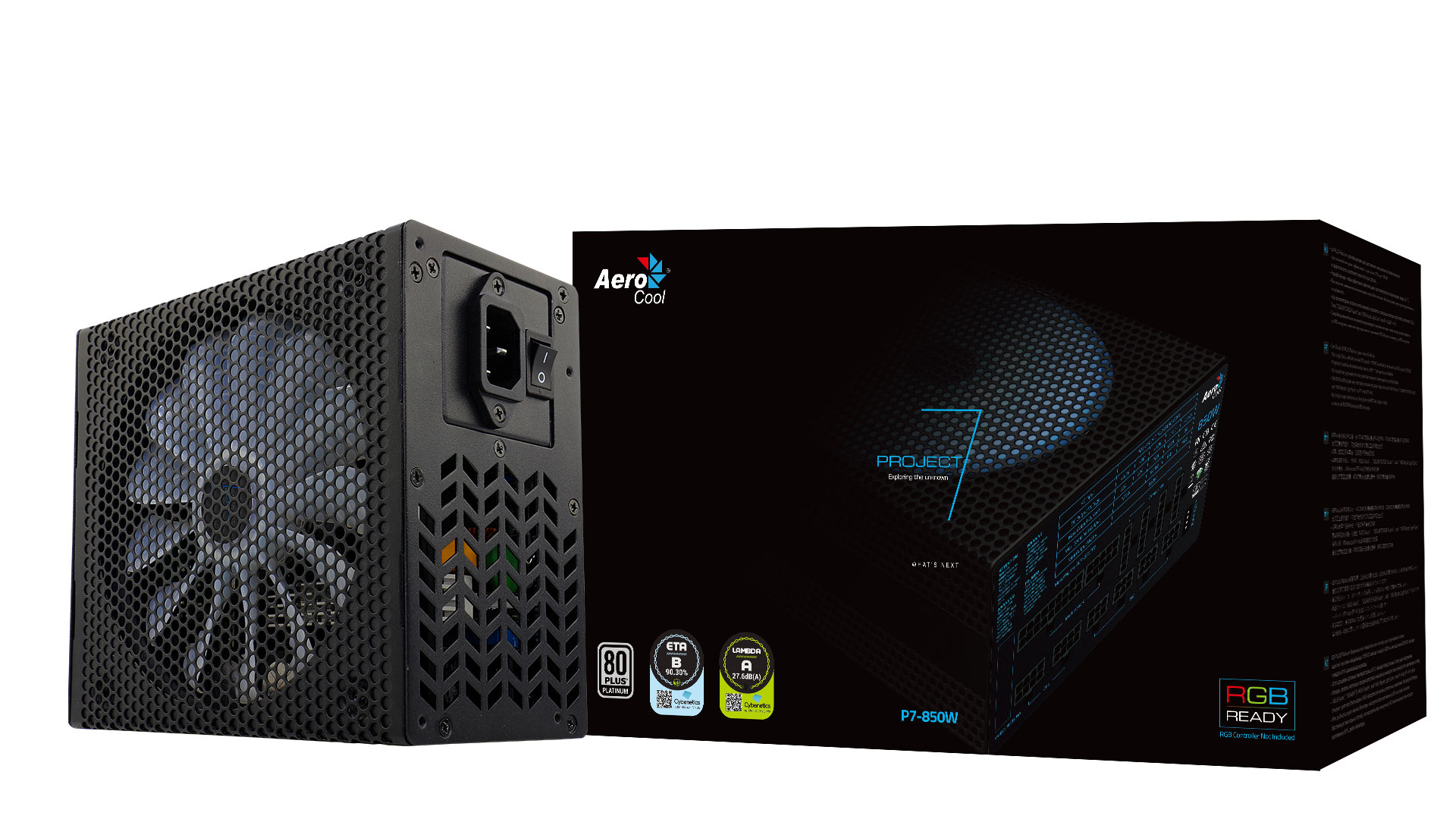

With great build quality inside and out, fantastic electrical performance including top-notch efficiency, and a generous selection of cables for the fully modular design, there is no real flaw with the P7-850W. Rated to 50°C and totally silent up to a respectable level of load, there's clearly a lot of value here.
The only issue as far as we can see is that EVGA's excellent competitor is available for £15 or so less and comes with a 10-year warranty versus the seven here. That said, Aerocool's advantage lies in its RGB fan, which we know will be important to some given it can be controlled through Aerocool's optional hub or your motherboard. The unit also uses flat, black cables rather than the thicker braided type from EVGA, which some may prefer as well. As such, the P7-850W is a great candidate for a high-end, RGB-themed build.
