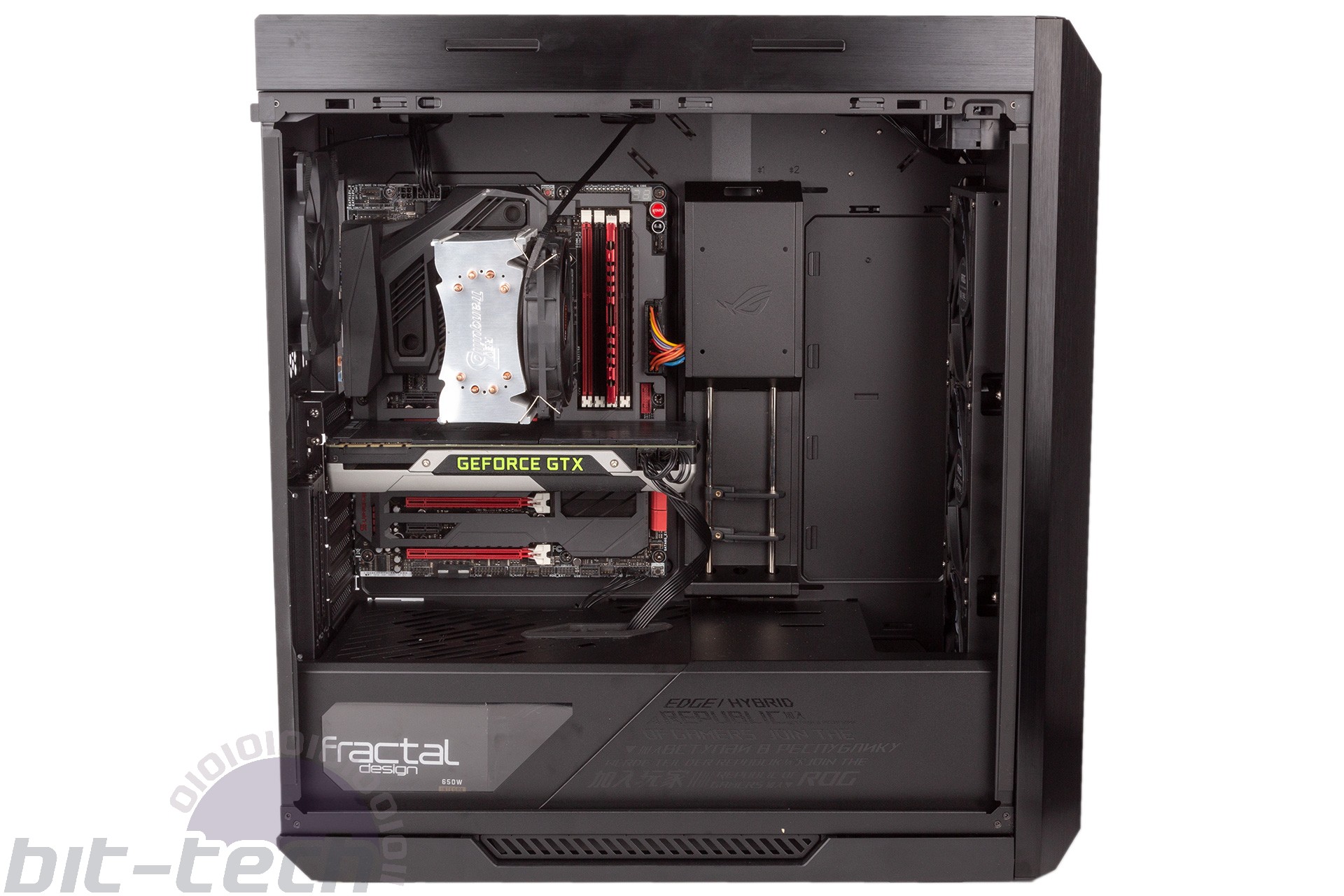

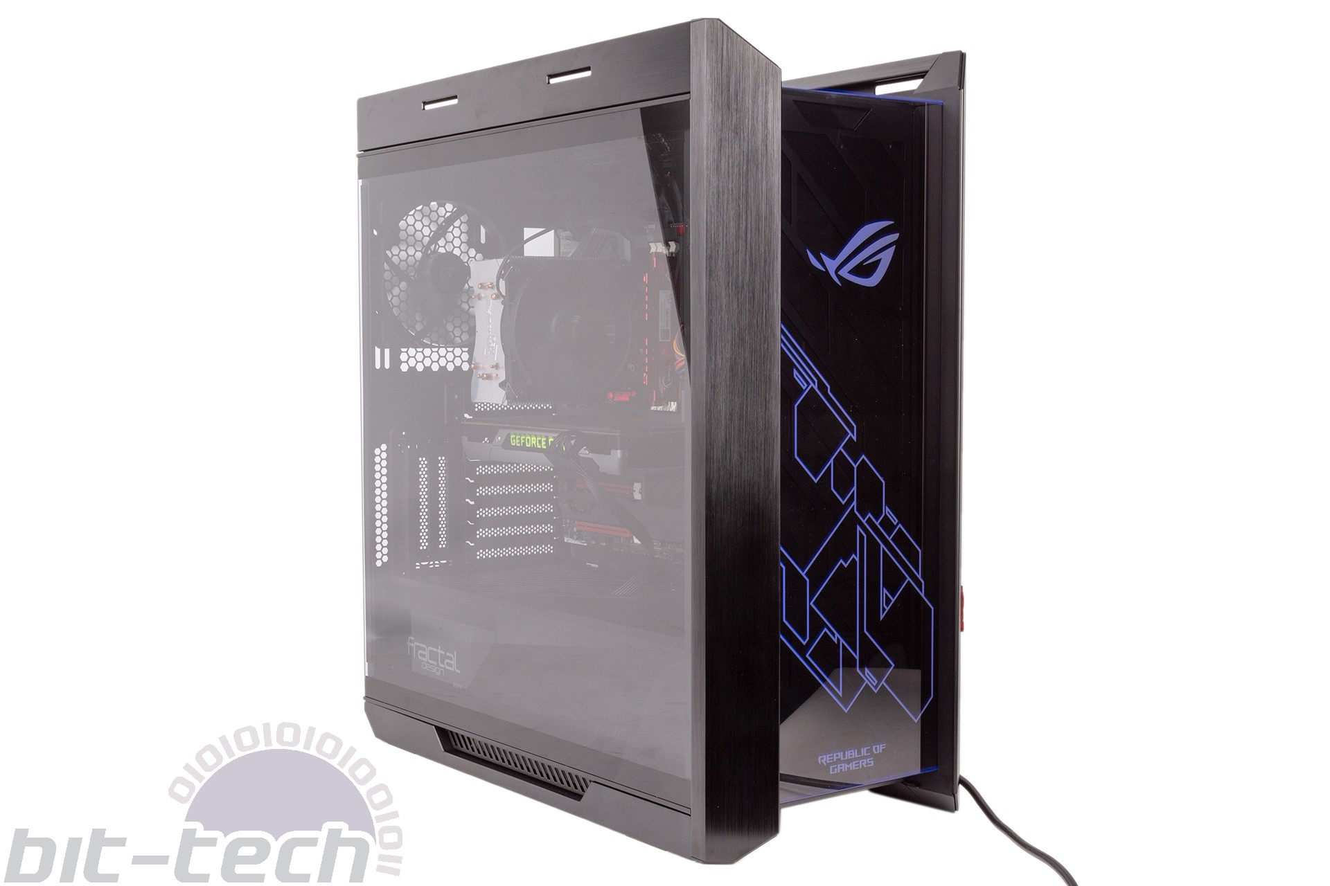

Starting with the positives, the material quality is consistently high, with the brushed aluminium roof struts really standing out. The integrated RGB lighting is tasteful, the easy-access side panels are well designed, and the I/O panel is very well equipped indeed with USB ports, fan switch, and LED control. Dust filter coverage is also top notch, and out-of-box airflow is good enough to keep temperatures in check. You do also end up with a very clean build once everything’s done.
Look closer, though, and there are multiple negatives. The PSU shroud design is complicated and fussy, and the cable management isn’t actually as good as it first seems. 3.5” drive support, both in terms of quality and quantity, is pretty poor too – we don’t believe they are as close to going extinct as this case implies. Other things like the residue on the sticker, the way the vertical mounts get in the way of the main horizontal ones, the lack of rubber on the pump mount, and the lack of captive thumbscrews in certain places may all seem nitpicky, but this is a £250 chassis. There is also less flexibility regarding layout and water-cooling than you can get elsewhere, and Asus hasn’t done anything new here that’s changed the way we think about case design, although the weaved handle is interesting, and dual vertical GPU support is undeniably cool too.
