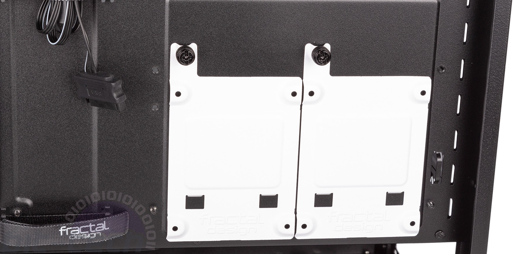

Two metal brackets for SSD mounting are secured to the rear of the motherboard tray using one thumbscrew each; these can either remain here or one or both can be moved to sit on top of the perforated PSU shroud, assuming a vertical GPU isn’t in the way.

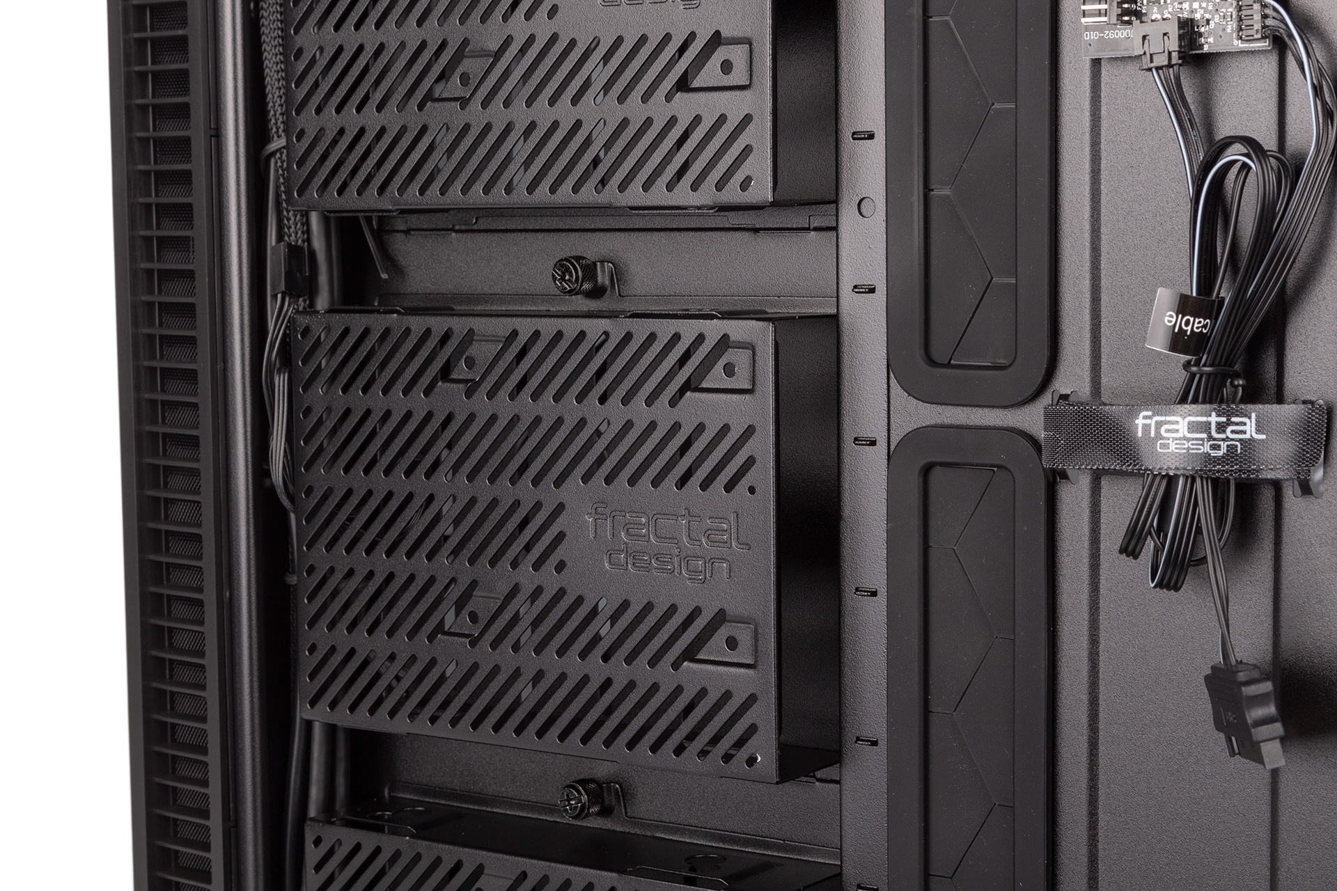

In the same area but at the front of the case, Fractal has a trio of metal drive cages, each one supporting one 3.5” or 2.5” drive. The former are installed with grommets to quell vibrations, but you do have to fit these yourself. This area will also have effectively zero airflow, so you’re better off only using HDDs here for bulk storage rather than frequent or intensive usage. Again these bays are secured using a single thumbscrew, but the proximity of them to each other can make it hard to access with your actual thumb.

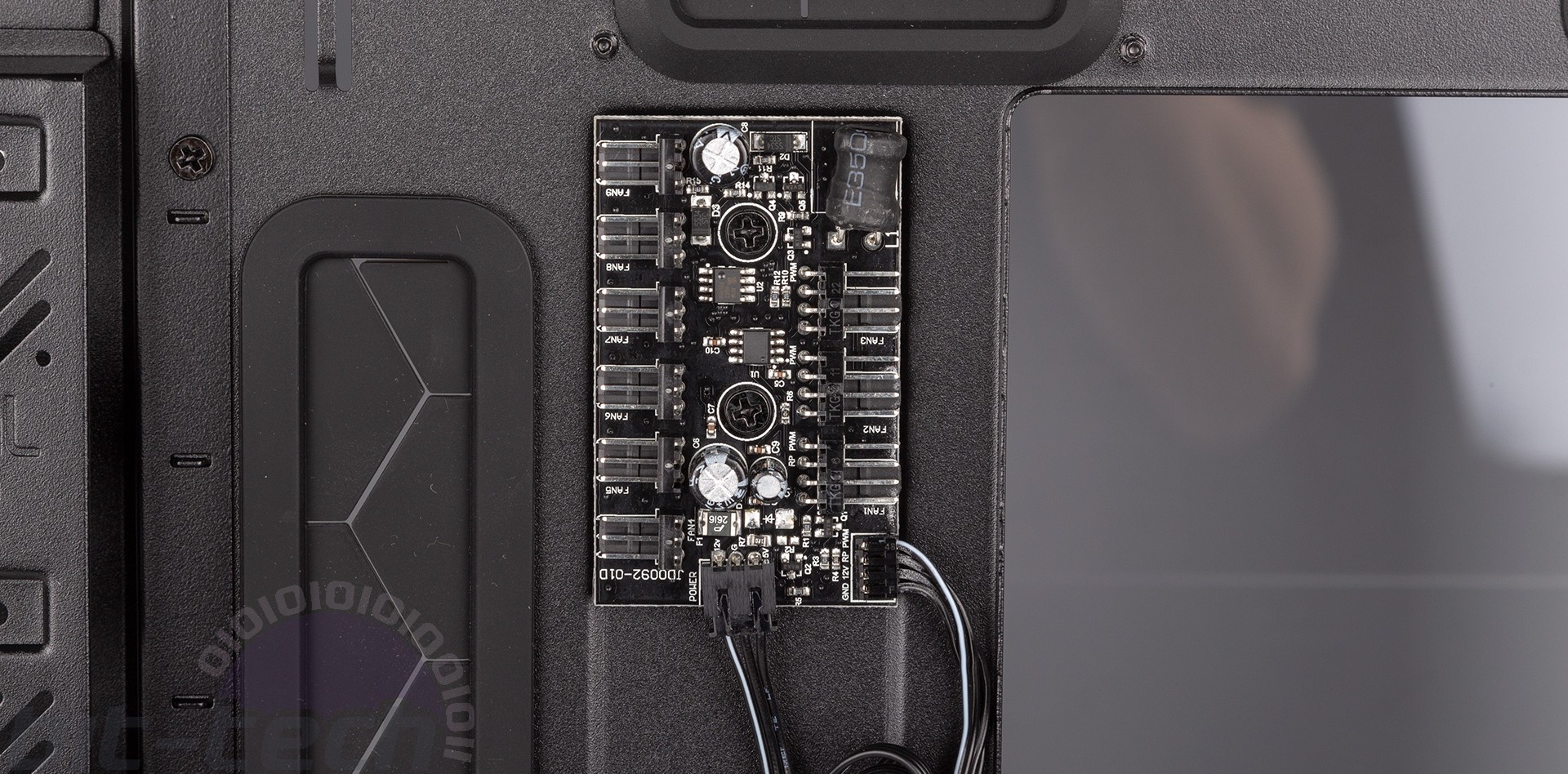

A fan hub is a good way to help keep busy systems tidy. Fractal’s here offers a combination of three PWM headers for four-pin fans, which will draw their control signal from a single PWM fan header on your motherboard (e.g. CPU fan) and thus respond to changes in CPU temperature, and six regular three-pin headers which will default to full speed/12V. This is fine for the 1,000 RPM models included here, but worth remembering if you fit your own higher airflow models. Power is received via a SATA plug, meaning total current cannot exceed 4.5A. It’s a little irritating that Fractal doesn’t ship the case with the included fans pre-connected, but it’s not exactly a cumbersome task. One neat addition in the accessory pack, though, is the braided SATA splitter cable; its three plugs are very easy to fit flat against the motherboard tray, which makes them useful for the SSDs you might have here – sometimes regular PSU cables have to be awkwardly wedged in.
