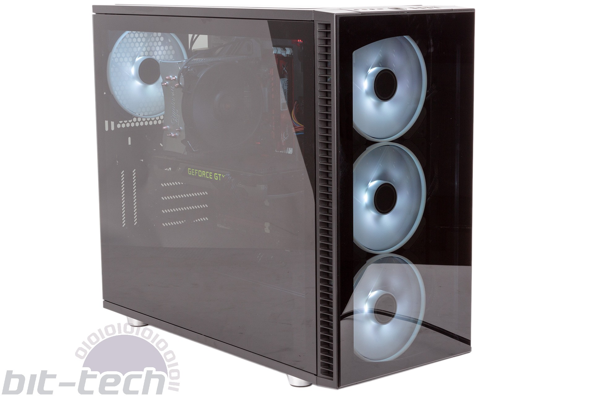

The Define S2 Vision is no more ventilated than the original case, but it does use faster fans (1,700 RPM versus 1,000 RPM) and there’s an extra intake fan as well. The good news is this leads to better performance, with a 2°C improvement to CPU temperatures and a whopping 7°C improvement for the GPU, which is much more sensitive to improved intake airflow.
We were also able to improve both measurements by a further 1°C by swapping to the ventilated roof panel, freeing this area up for natural exhaust airflow. However, this difference is within the margin of error.
The downside is that things are relatively loud. In the interest of keeping variables down, all our testing is done at fixed fan speeds, meaning only full speed for this case. With all four fans at full speed, the case is louder than we’d like.
Thankfully, the PWM fan hub will allow users with modern motherboards to play around with fan curves, perhaps even capping the maximum fan speed if it’s deemed too loud. Regardless, the limited ventilation means you’ll have to drive the fans higher and louder to reach equivalent performance levels to an airflow-optimised design, but the wide speed range of the fans does at least allow users to find a good balance and make the most of the Define S2 Vision’s design.
