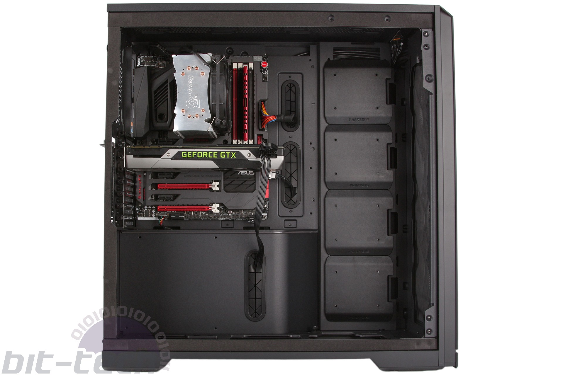

With Phanteks focussed on letting users do whatever they want with the Enthoo Pro 2, testing the thermals in its default state with a bog-standard ATX build isn’t all that useful to most potential buyers, especially when it doesn’t even come with any fans. Still, we always think it’s worth doing to remind users why fans are important and give us some comparable numbers. We’ve tested in the default state (no fans) and then added a couple of 120mm fans (one intake, one exhaust) to see the difference that a little airflow makes.
With no fans, the Phanteks Enthoo Pro 2 joins the other cases on test that have very little or no airflow. Within the 15-minute test, the overclocked CPU gets too hot and eventually throttles. No big surprise, then, and a reminder that even if you have a great air cooler, you’ll very likely see higher fan speeds and/or temperatures when your CPU is loaded if you don’t ensure that it is served with adequate airflow.
With our two extra fans installed and capped to 7V, the same thing eventually happens albeit not as quickly as with no fans, suggesting that the little airflow this introduces isn’t all that helpful in so large a case. With the fans at full speed, the CPU no longer throttles, but it wasn’t far off, so you’ll definitely want to ensure you have good levels of exhaust airflow, ideally utilising both the rear and roof fan mounts when planning your build.
As for the GPU, the case is well-ventilated enough to ensure GPU coolers are not starved of air, but the default setup does give us a warm result. With our fans fitted but running at 7V, there is technically an improvement, but it’s within the margin of error. Only at 12V do we see a meaningful improvement, and the delta T of 49°C is right near the top of the chart, nestled in with an open-air test bench and the MSI MPG Sekira 500G when it has no front panel and almost entirely unrestricted airflow from two 200mm fans. That’s a pretty good result from a single 120mm fan in a massive case, and it suggests that Phanteks’ claims related to its mesh front panel are well founded.
