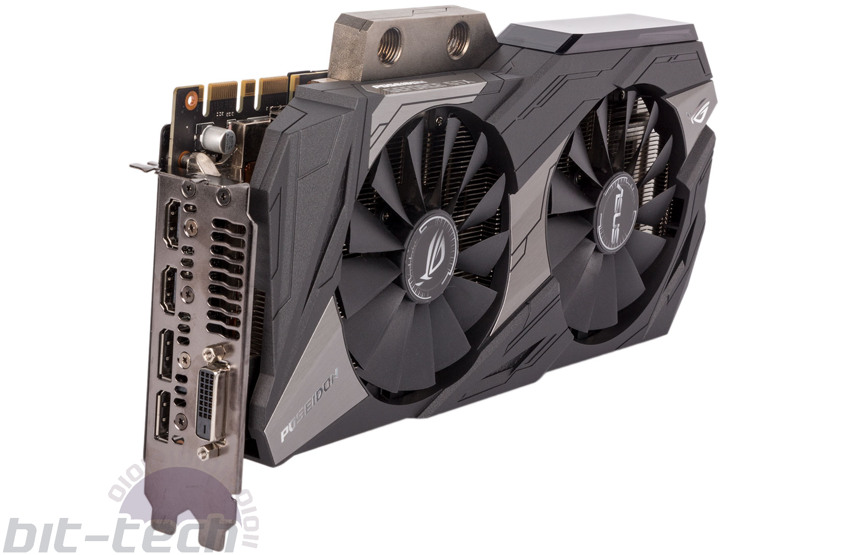

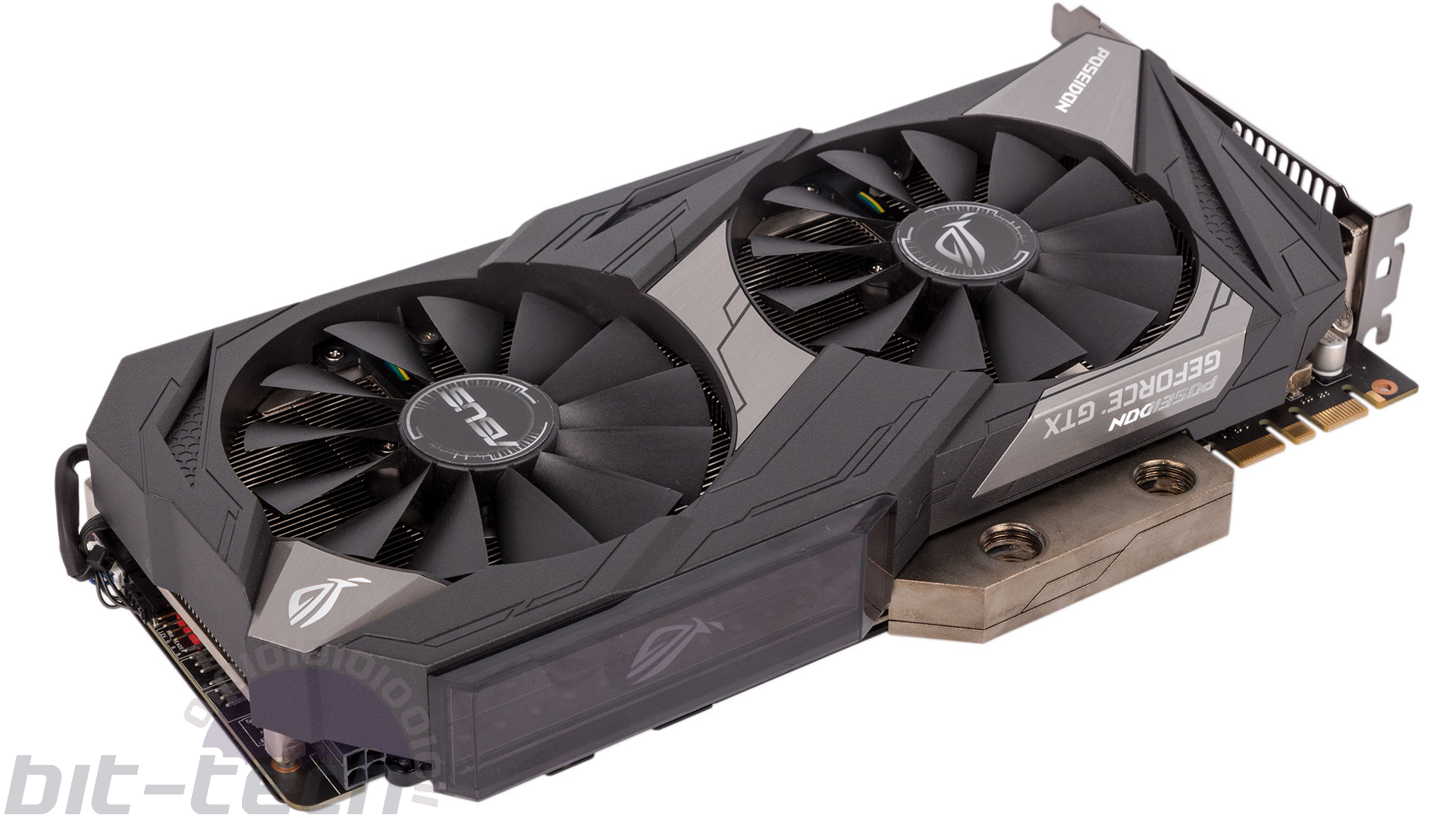

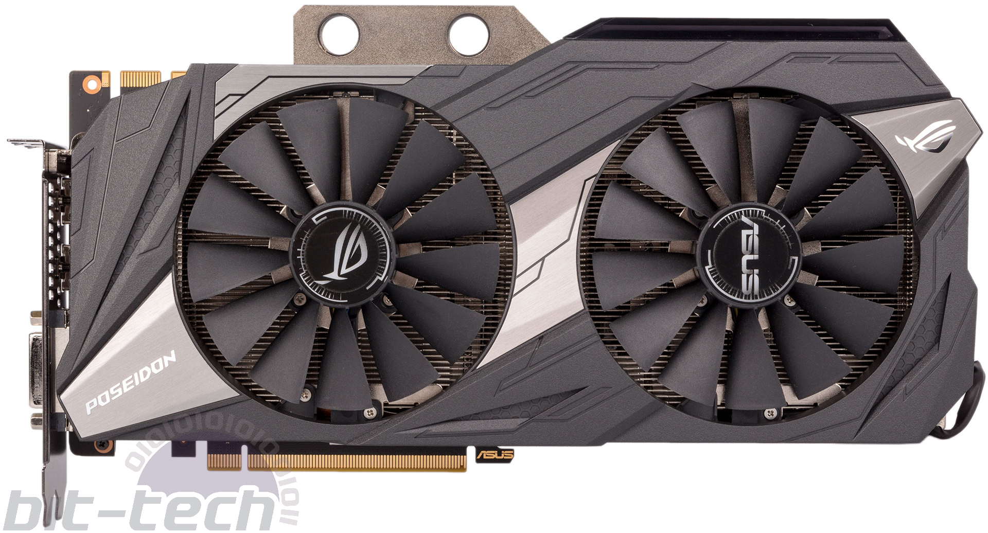

Out of the box, this cards holds its own against other GTX 1080 Ti cards that have marginally higher clock speeds and better coolers – the Inno3D one has a built-in all-in-on liquid-cooler while the Aorus one sticks with air but is better for being designed solely for air rather than air and water like this one. The frame rate differences are effectively meaningless.
Of course, you’re unlikely to buy a card like this just to air-cool it, at least not permanently, as it’s the ability to water-cool it that is the standout feature (as well as a big bulk of the cost). If you choose to take advantage of this, you’ll immediately be rewarded with higher clock speeds; the most common in-game boost speeds of 1,860MHz and 1,886MHz in Gaming Mode and OC Mode increased to 1,936MHz and 1,949MHz respectively simply by dint of being under water thanks to the improved thermal headroom. Admittedly, this isn’t enough to make a difference beyond a few fps in games, but it’s worth noting that when the card was overclocked on air alone, its boost speed was only reaching 1,974MHz.
The most obvious difference water makes is to temperature, and our GPU dropped from a delta T of 59°C to just 39°C. This is a considerable difference, of course, but this result is still only 1°C better than that managed by the Inno3D GTX 1080 Ti iChill Black, which uses a simple all-in-one liquid-cooler with a 120mm radiator and single, PWM-controlled fan instead of our more elaborate (and expensive) custom setup with a separate pump, reservoir, 240mm radiator and dual fans running at full speed. We think it is safe to say, therefore, that you will get considerably better mileage in this regard from a true custom water block, though that's unsurprising given the necessarily compromised designed this one uses.
Another knock-on benefit is to noise. With the GPU kept so cool, the fans barely have a reason to turn on. From running at a clearly audible level of 76 percent (just over 1,800 RPM) when under prolonged load (raised to 83 percent or around 2,000 RPM when overclocked), the behaviour under water meant the fans peaked at a very modest and inaudible 32 percent (about 750 RPM) using out-of-box settings and only a touch higher when we overclocked it manually.

What the GTX 1080 Ti ROG Poseidon Platinum offers – uniquely, as far as we can tell – is the ability to buy the card now, game immediately, then upgrade to a water-cooling loop later without having to break your warranty or invest even more time, money, and effort in fitting a block.
To be sure, this is going to be a (very) niche audience, but it’s one that this card serves very well, so it’s for those and those only that the award below applies to. There are compromises both from an air and water-cooling perspective (noise for the former, size for the latter, and temperature for both when compared to dedicated solutions), so it helps a lot that it’s so well built, heavily overclocked, good looking, and comes with some tasty features like the onboard RGB and fan headers. If you’ve decided that the card meets your needs and are just looking for a seal of approval, we’re more than happy to bestow it here.
