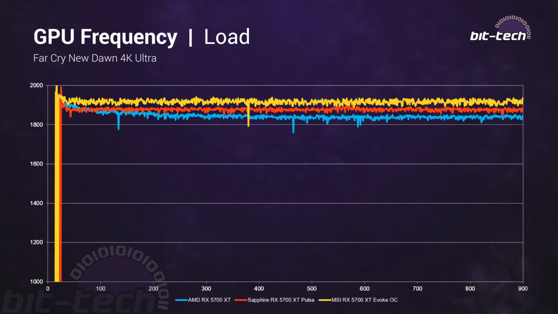

Plotting frequency over time shows nicely the differences between the three cards we’ve looked at so far, and MSI’s card is the only one to sustain over 1,900MHz under prolonged load. We did not plot the Silent Mode BIOS, as it is simply too similar to the regular one in terms of GPU clock speed.
