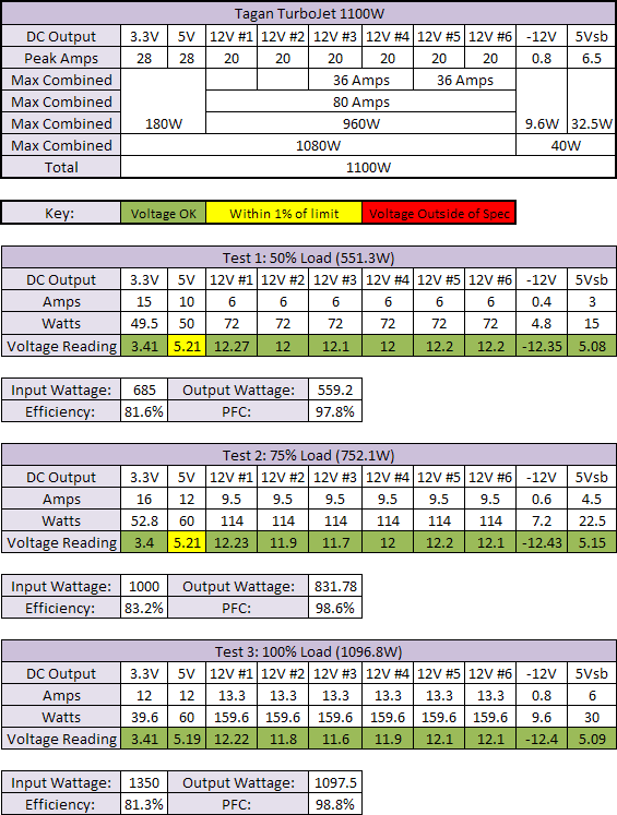

The Tagan is actually overzealous to the point where it pushes the upper limits of the ATX specification at 5V. The 3.3V, -12V and 5V standby voltages are all slightly high as well, but not quite as near specification. Slightly higher voltages are better than slightly lower, although too high (outside of ATX specification) could potentially cause component damage.
The six rails on the Tagan can be loaded high in addition to the 3.3V and 5V which wasn't the case for the Seasonic and Silver Power PSUs meaning a greater variety of higher wattages is capable from this power supply.
The PFC rating increases as the load does as well, going from a high 98 percent to scraping the under side of 99 percent. Only the Seasonic was slightly better, but really this is a superb result. It's joined by the 81-plus percent efficiency, which tops out at a massive 83 percent at 75 percent load. From the result, we can't complain at the slight over powering of the rails and, all in all, Tagan has made a superb and true 1100W PSU.
