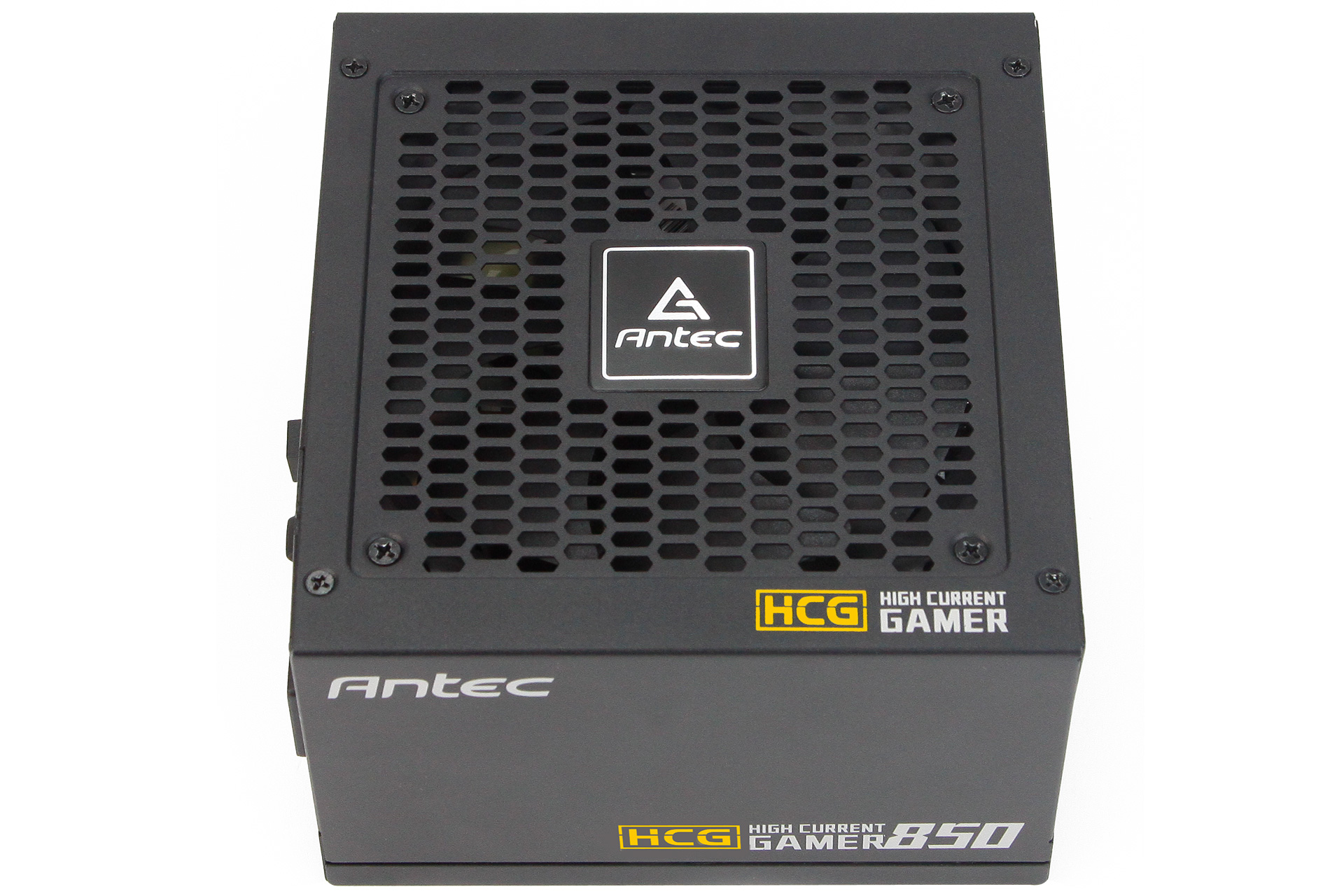

Noise output was always a concern. A cramped chassis means a denser concentration of heat, and the 120mm fan has to work harder than the 135mm one in Be Quiet!’s PSU, for example. It is especially noticeable at full whack, so if noise is a primary concern you may want to switch to a bigger unit.
While it isn’t the very best value 850W 80 Plus Gold power supply on the market, the Antec HCG Gold 850W is certainly not overpriced. The build quality inside and out is high, the cable selection is sensible and generous, and it boasts full modularity as well as solid performance. It’s also more compact than most competing models, which will boost its appeal to a certain subset of users looking to maximise space. This does entail the downside of a smaller and thus noisier fan than much of the competition, but with its 10-year warranty and very low ripple values, the Antec HCG Gold 850W does enough to earn itself a shiny Recommended badge.
