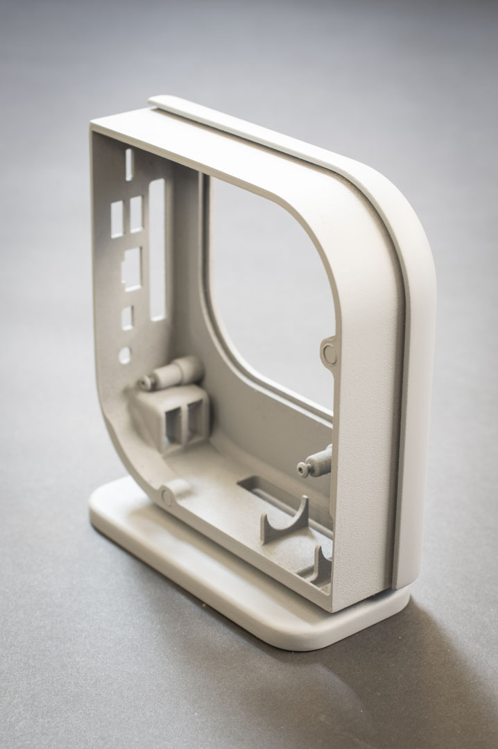

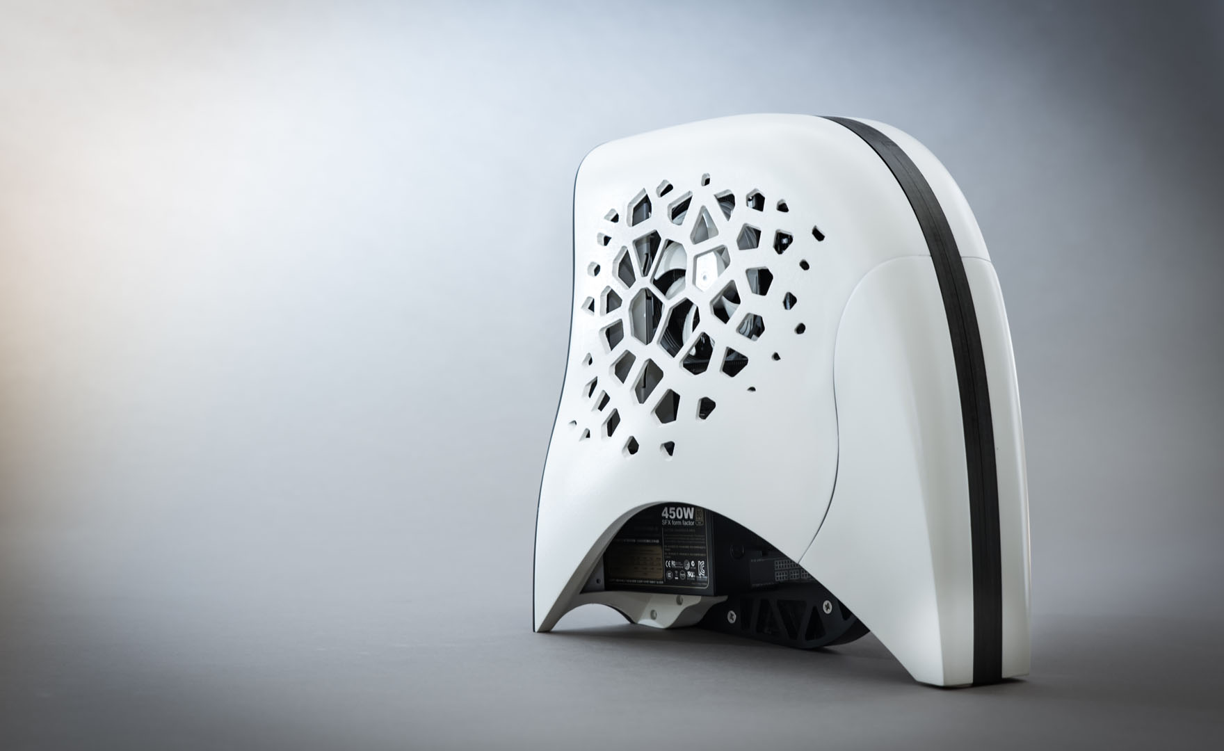

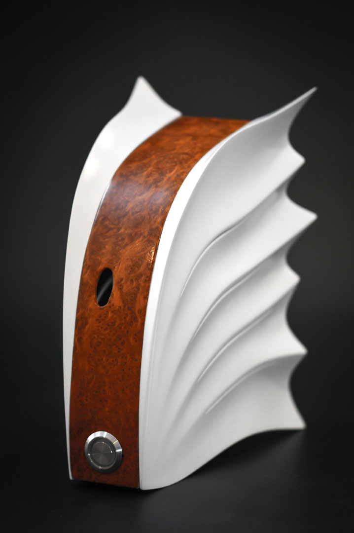

Interestingly enough, I've actually already done a few 3D-printed case mods, the first being for the 2013 bit-tech Design a NUC Contest, then again for the 2015 one, and then lastly for a system build for AMD and its #makeitnano initiative. All three of these mods used SLS nylon printing, however, chosen because it produces very high quality, strong parts that are fairly straightforward to process afterwards.

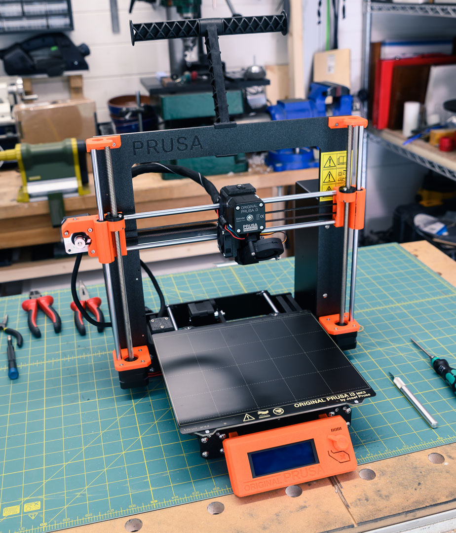

One thing that the Prusa has in spades is community support, as so many units have been sold by now. This meant that it would be, in theory, easier to find solutions to potential problems. The Prusa is based on the tried and tested i3 platform used by many other kit printers. It can also be supplied fully assembled, although I opted for the kit so that I could get a better understanding of how the machine operates - handy for upgrades or troubleshooting. It was also simple finding lots of reviews, meaning the pros and cons of the machine were widely published, again a real bonus. The print volume is also pretty decent for a printer of this size, with 250x210x210mm available to play with. I'll likely want to upgrade to a larger format machine down the line, but this should be a good starting point.

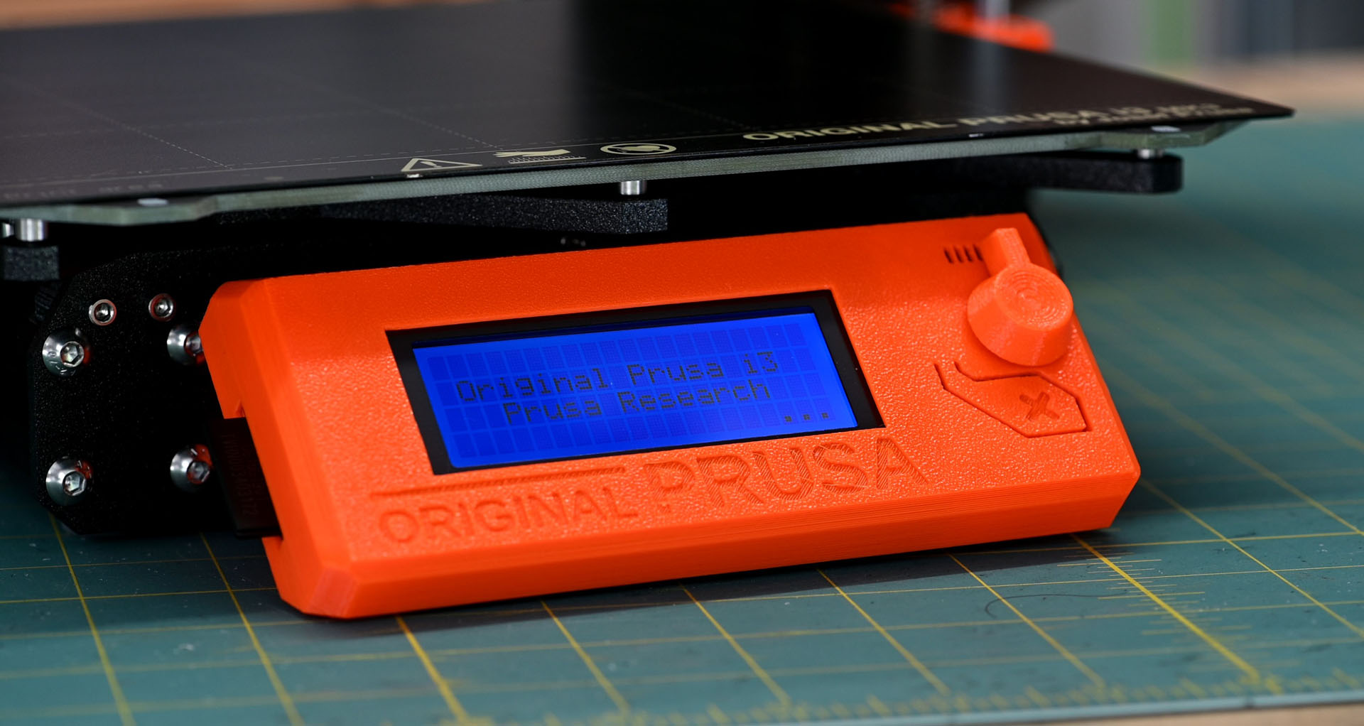

The Prusa i3 MK3S comes with a host of modern features, including a heated removable steel bed, automatic bed level compensation, and a filament sensor. That said it does have a fairly dated interface compared with some other kits around nowadays that use touchscreens, and the filament sensor is a simple mechanical/optical type that doesn't aid with detecting jams. One thing I do like, though, is ability to upgrade the kit to a newer version by simply ordering the replacement parts. This means that if a future upgrade contains features you fancy the look of, it's straightforward to add them to the machine you already have.

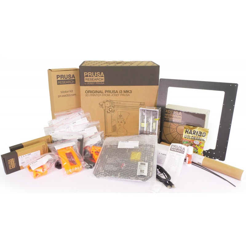

The video goes into more detail here, as frankly it's largely a case of following the instructions provided in the substantial construction manual. The kit arrived neatly packed in a series of labelled boxes, with all the pieces laid out clearly and concisely. There was also a pretty decent pack of gummy bears! I was honestly taken aback by how easy to follow the instructions were. Each step was given a thorough but concise description along with handy pictures to help show the necessary actions. Locating all the parts for each stage was simply a matter of retrieving the suitably labelled bag of bits, and there were even scale diagrams present for the purpose of identifying different screw types. I thought this was a nice touch; I work with lots of different screws on a daily basis, but it's still a bit tricky discerning a 14mm screw from a 16mm one at a glance.

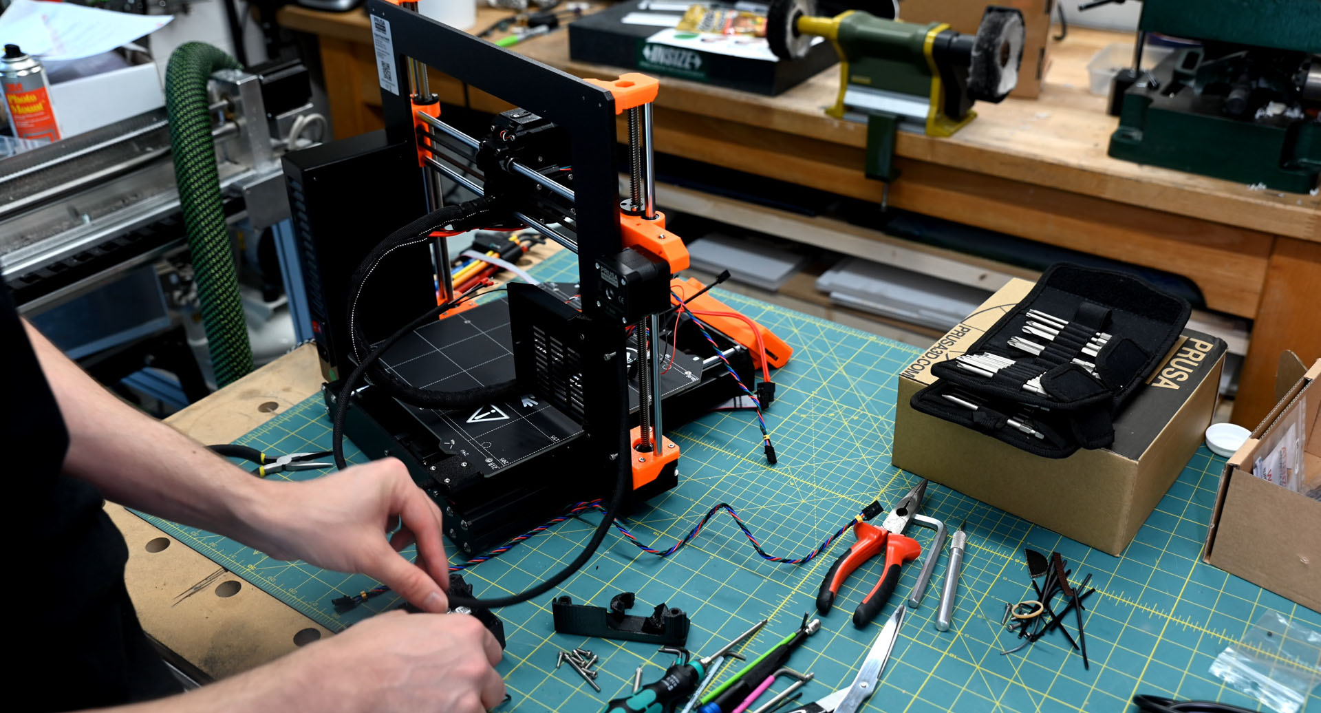

The kit comes with all the tools necessary for the construction too, although I ended up using my own ones plus a few extras (such as an iFixit socket set rather than pliers to hold nuts in place) to make some of the steps simpler. Again this is a nice touch, as it means the kit is literally ready to assemble straight out of the box. In terms of complexity, if you like Lego or Meccano (so literally everybody, right?) then you'll have no trouble with the Prusa i3. There are a few quirks that did get a bit frustrating at times, such as inserting the square nuts into little slots, but for the most part these went smoothly. It's quite interesting to note how many components were actually 3D-printed in the kit vs injection-moulded. I suppose it makes sense for a 3D printing company to do this, although with the number of parts being produced (Prusa Research is hardly the one-man-band it was when Josef started it) I would have thought it might be more viable to mould some things like the axis housings.
The one tricky part I encountered was trying to insert the E-axis linear rods into their holders. For the life of me I couldn't push them in, so I resorted to using the little jack-clamps I have for the workbench to gently push them into place without damaging the 3D-printed components. I'm not entirely sure what I would have done without those, perhaps attempt to sand the interior or enlarge the hole a smidgen? Either way, it might be a good thing in the long run, as the axis is now rather rigid.

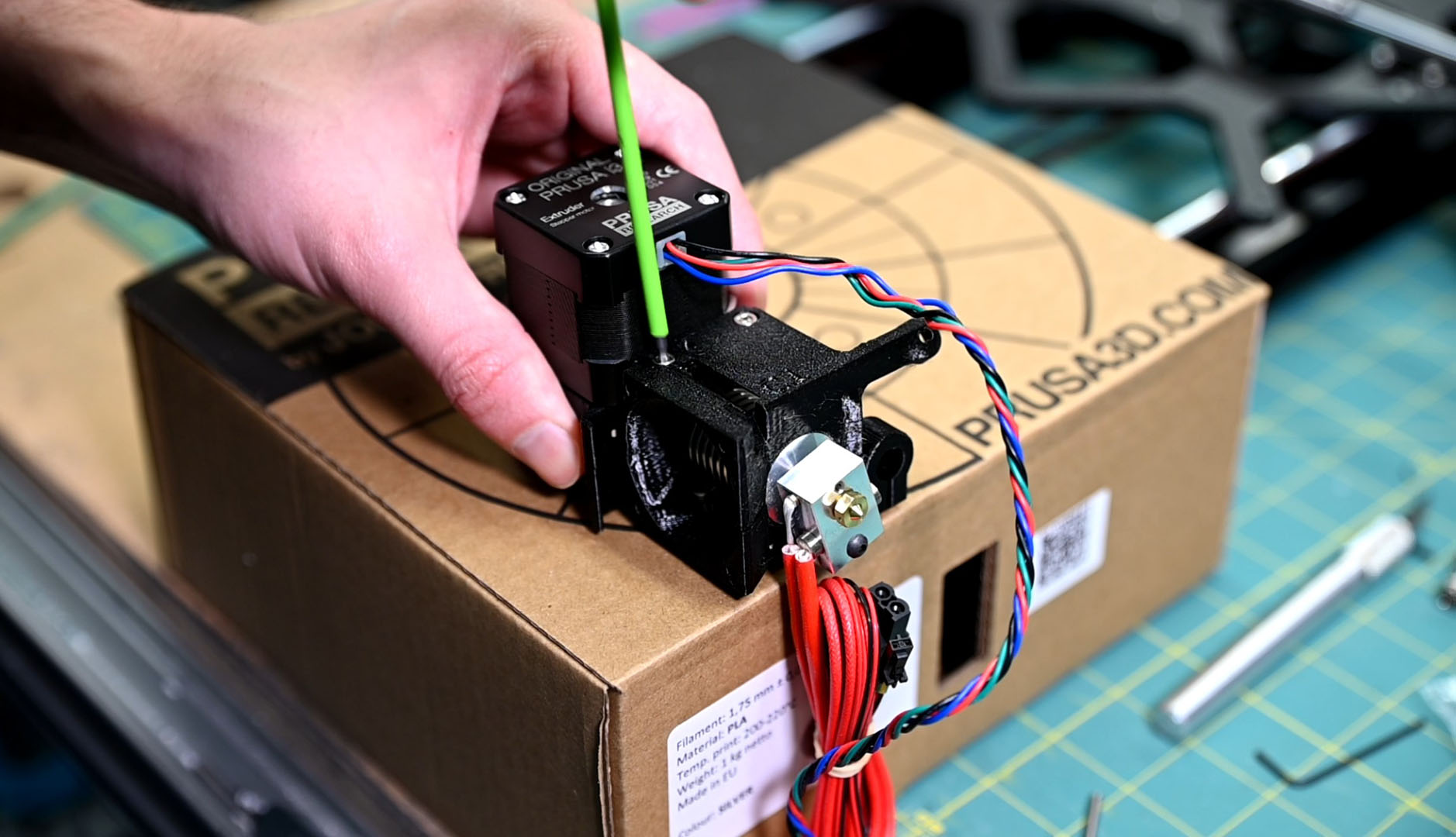

Assembling the extruder head was a little on the fiddly side, although in the end it didn't prove that troublesome. The parts all mated together nicely, and getting things running smooth and true wasn't hard at all. The wiring for the printer was also delightfully simple too! Cable management was carefully thought through, so each stepper motor has an appropriately measured set of cables, likewise for the control box and extruder parts. This meant that everything came together with a minimum of fuss. It's also a nice touch that the hot-end cooling fan is a dinky little Noctua!

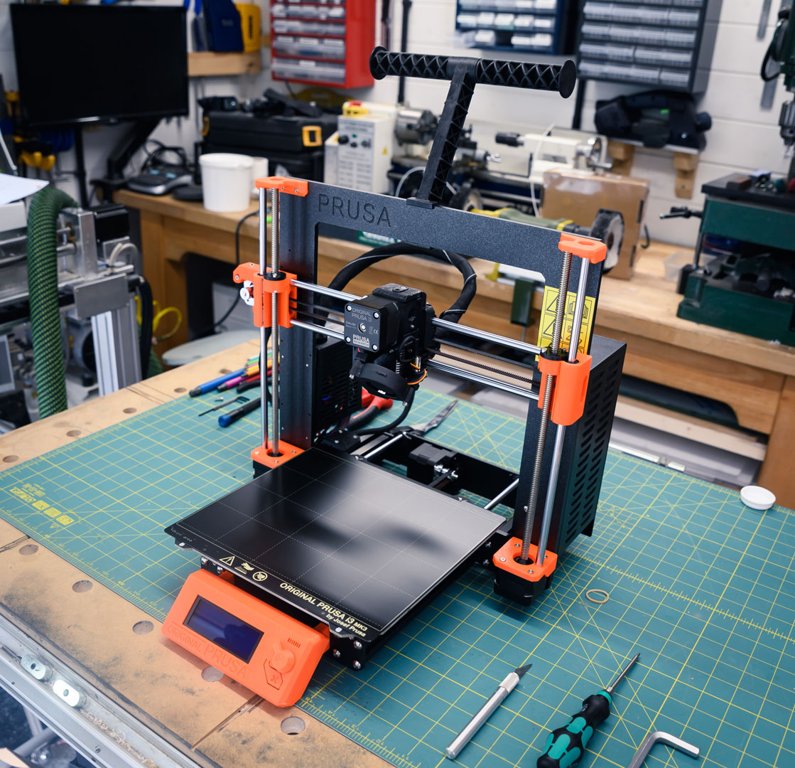

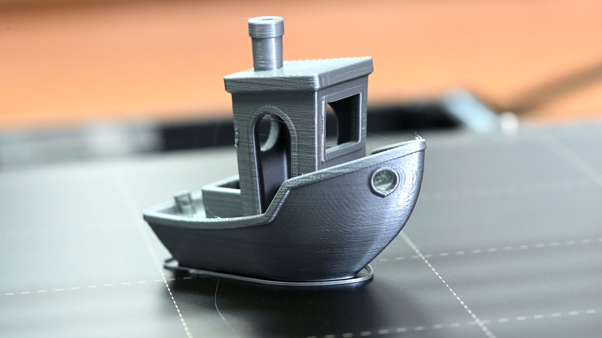

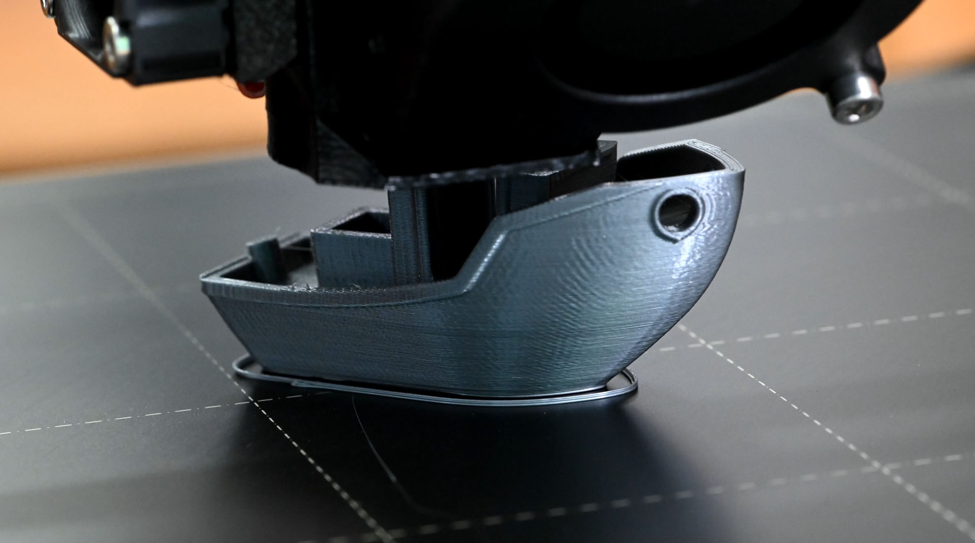

With the calibration complete, I loaded up a couple of the default models that come pre-packaged with the printer on the supplied SD card. First on the list was the Prusa logo, printed in the silver PLA that's supplied. This was beyond satisfying; the print itself wasn't all that exciting, but it's hard to hide away a cheesy grin when observing a machine whirring away making something when only the day before it was just a bunch of bits on a table. Of course, I had to follow up with a 3D Benchy, printed at 0.2mm layer height, along with a tree frog at 0.05mm. Print quality on the Benchy was, in my eyes at least, fantastic. It's not a hard model to print by any means, but it was cool to see how smooth the contours were. It felt worlds apart from the early FDM printers I remember seeing in the foyer at university.
The tree frog was less successful, with some noticeable stringing present along with some surfaces that weren't so smooth. That said, I'd put this down to the layer height being so low, so perhaps it would fair better with a smaller nozzle than the standard 0.4mm one supplied with the kit? I hadn't played either with some of the other settings that can help with more complex prints such as Z-hop or retraction. PLA is a very forgiving material to print, so it will be interesting getting to grips with some of the other options such as ABS, PETG or the flexible filaments. There's also a multi-material upgrade kit available that allows 5 filaments to be used at once, although I think I'd want to look into that further before considering it. The main use I could have for a kit like that would be printing in water-soluble support materials such as PVA. That said, it would be pretty bad if I accidentally ended up contaminating the main print with it!
I'm definitely excited to see where this is going to head, though. For the time being, it's largely going to be a case of learning the ropes and getting to grips with how to print reliably with different materials. I'm definitely considering building an enclosure too, which in theory could make ABS printing less failure prone. Constructing an external filament holder would also be a sensible move I reckon, as currently the stand puts a lot of weight at the top of the frame, which can't be that great for stability. Onwards and upwards!
