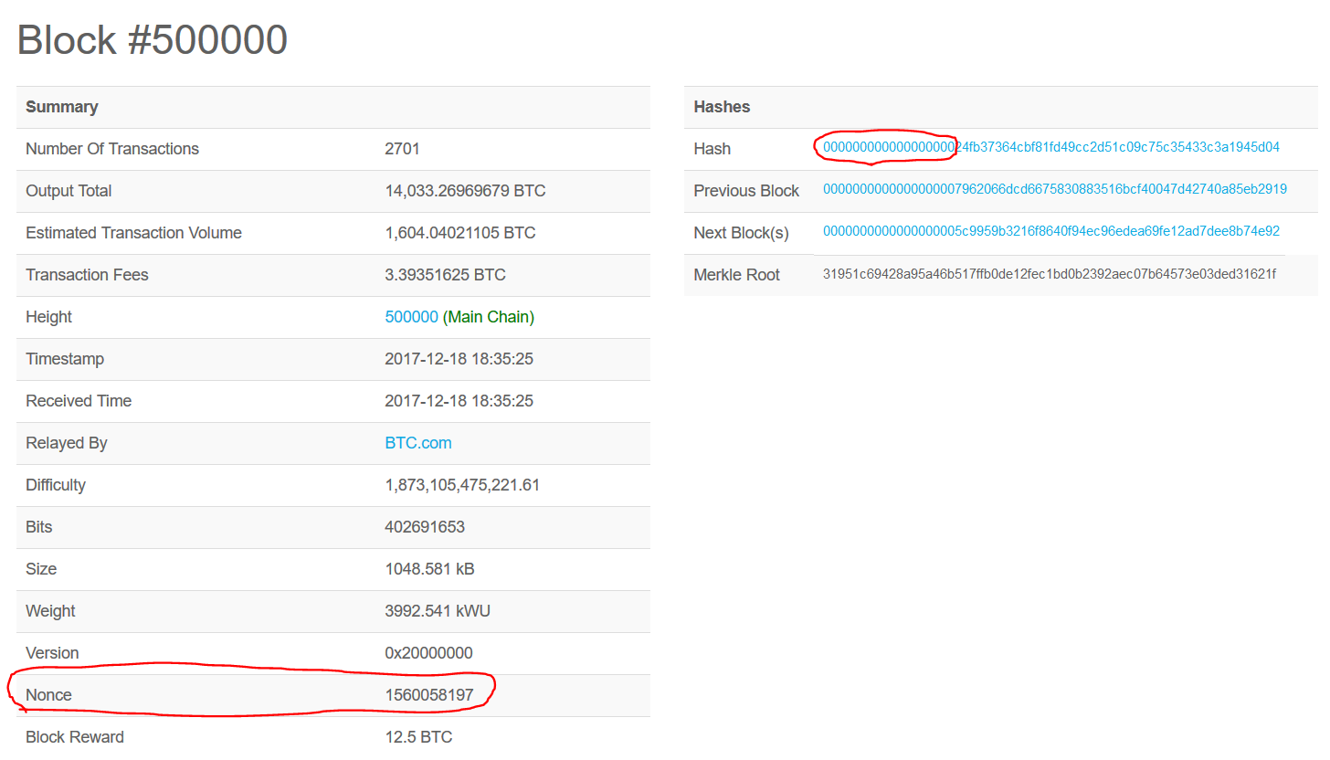

Mining is the process of assembling transaction blocks and discovering “correct” hash values for them. Instead of just running the SHA-256 function on the data of the block to produce an output, Bitcoin requires that the first however many bits of the resultant hash are 0 (i.e. that the hash is lower than a given value). To do this, miners use computational resources to pair the block data with a random number – a nonce – and run it through the function until the output is one with the desired number of 0s (see below for a real example from blockchain.info). This is a process known as hashing, which is where you get the term hash rate from. A miner that can hash at 1 MegaHash per second is guessing roughly one million nonce values every second. Once the nonce is discovered, the assembled block is then broadcast and added to the blockchain, and the process begins anew.
The number of 0s required for a block's hash (known as the difficulty) is increased or decreased in order to keep block creation at around 10 minutes (another characteristic that can vary by coin) – achieved using a formula that refers back to the timestamps of previous blocks to assess how fast they were created, meaning difficulty responds to increases or decreases in the network’s overall hash rate. If the requirement is that the first 32 characters are 0, the probability of a random data set producing an output that matches this is one in 2^32, or roughly one in four billion, so that's how many values would need to be guessed on average before a suitable output was produced.
