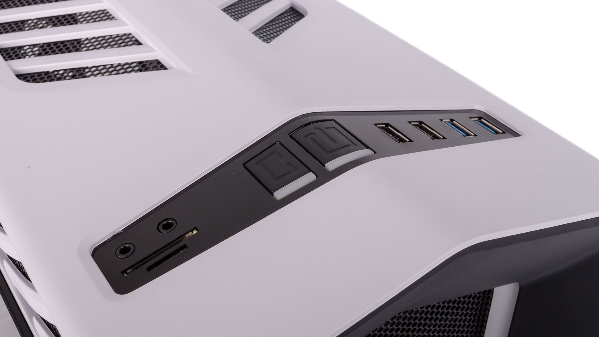

The I/O panel is located on the roof. The power and reset buttons feel a little flimsy, but there’s good connectivity including an SD card reader and four USB ports (two at 3.0 speeds).
Ventilation slits in the outer roof panel allow for airflow here, although there’s no dust filter. That said, where Aerocool has used dust filters, the design leaves a lot to be desired. For example, getting the front filter out is a five-step process in the manual, as both side panels to be removed before the front panel will come off, and even then you need to unplug the panel’s LED cable for it to come away cleanly. For the PSU, meanwhile, there’s a thin sheet of material wedged into some notches, but the plastic bottom panel makes accessing it near impossible – we can’t see how you’d refit it without a lot of frustration. We could potentially overlook this design in a sub-£50 case, but at this price a slide-out filter here is basically a necessity.
