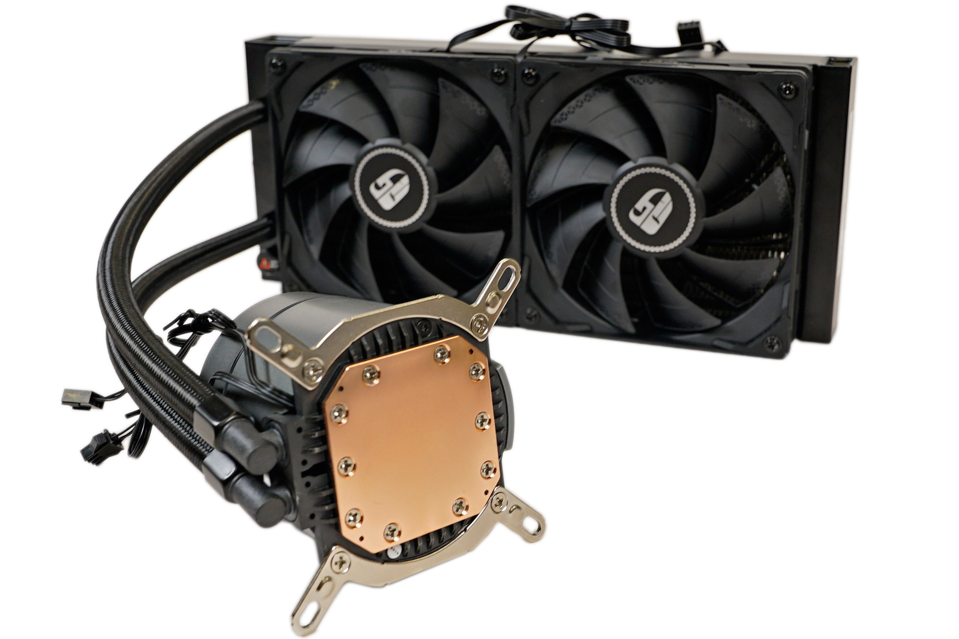

Elsewhere, it’s business as usual. As the name indicates, this is a 240mm-based solution. The aluminium radiator is decidedly slimline at 27mm, so most cases these days will be able to house it, although the pressure-relief device adds a little more length than would otherwise be needed.

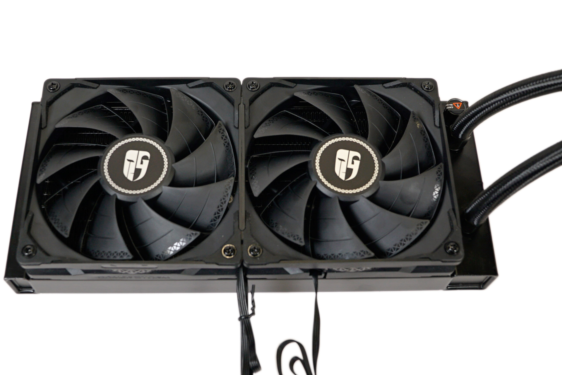

The supplied fans are custom-tuned TF120 S models with nine blades and an all-black design. They’re PWM-enabled, and Deepcool supplies a splitter cable to save you a fan header. Neither this nor the fan cables themselves are braided, however. One feature we do like is the rubberised corners, as these should help with reducing any vibration noise. They are expected to be available to buy in the UK as standalone models on 21st September.
The tubes have a good quality braiding, and we feel they are just right in terms of thickness too. They are highly resistant to kinking but easy to manoeuvre.

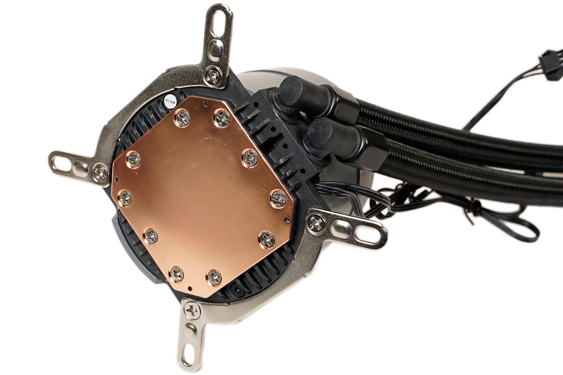

The pump unit is relatively tall, and the copper baseplate is on the large side – the cooler supports Socket TR4 out of the box. Thermal paste is pre-applied, and the amount is sensible, but you don’t get any extra, so you’ll need some to hand should you ever need to remount it. Deepcool says it is now using 25 percent extra skived fins on the reverse side (where the coolant hits), which means more exposed surface area – generally a good thing.

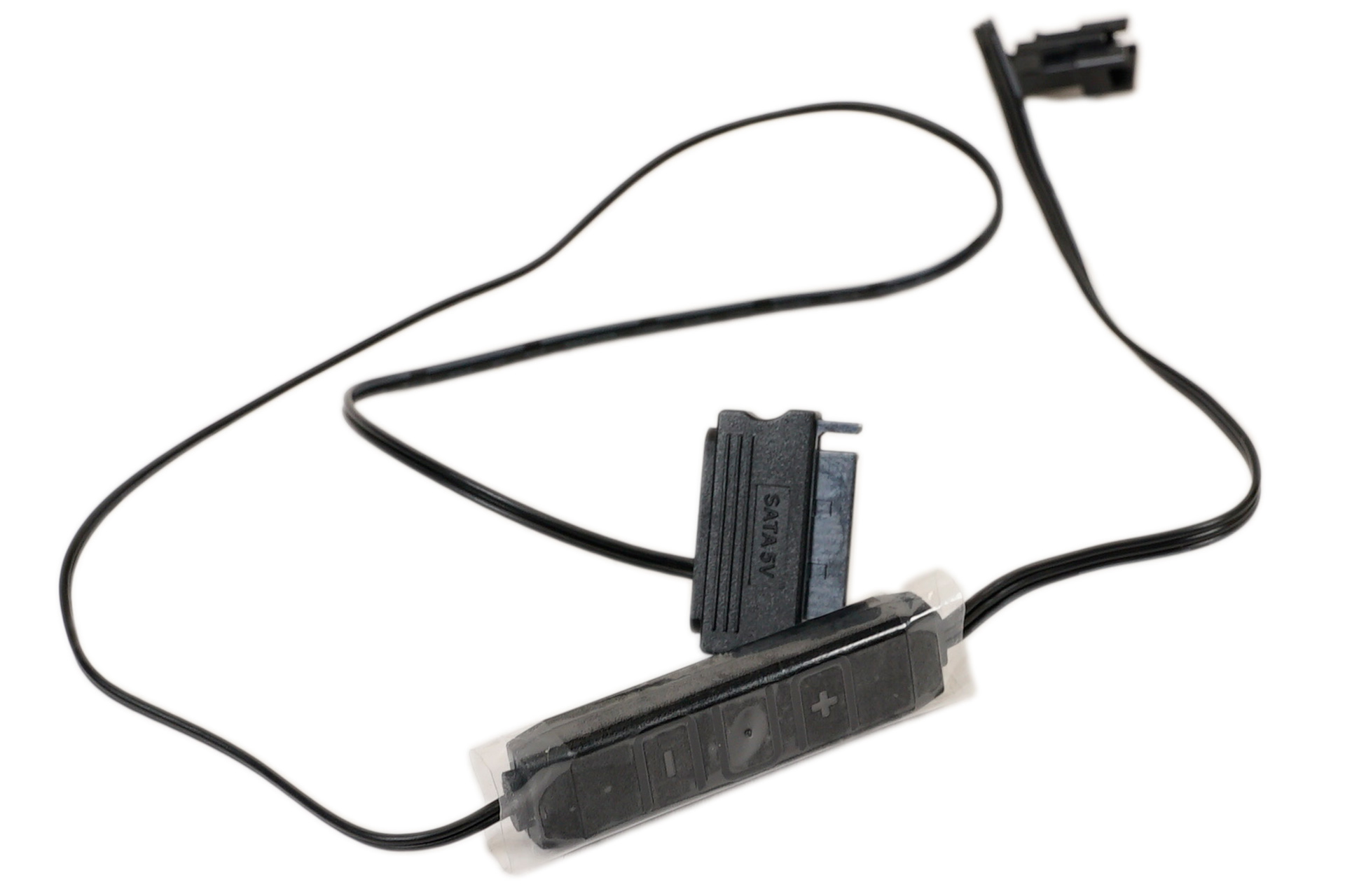

You get labelled cables to help you hook it up properly to your chosen motherboard brand; alternatively, a SATA-powered controller lets you cycle through a bunch of colours and effects. It’s plastic and cheap, but it does what it needs to.

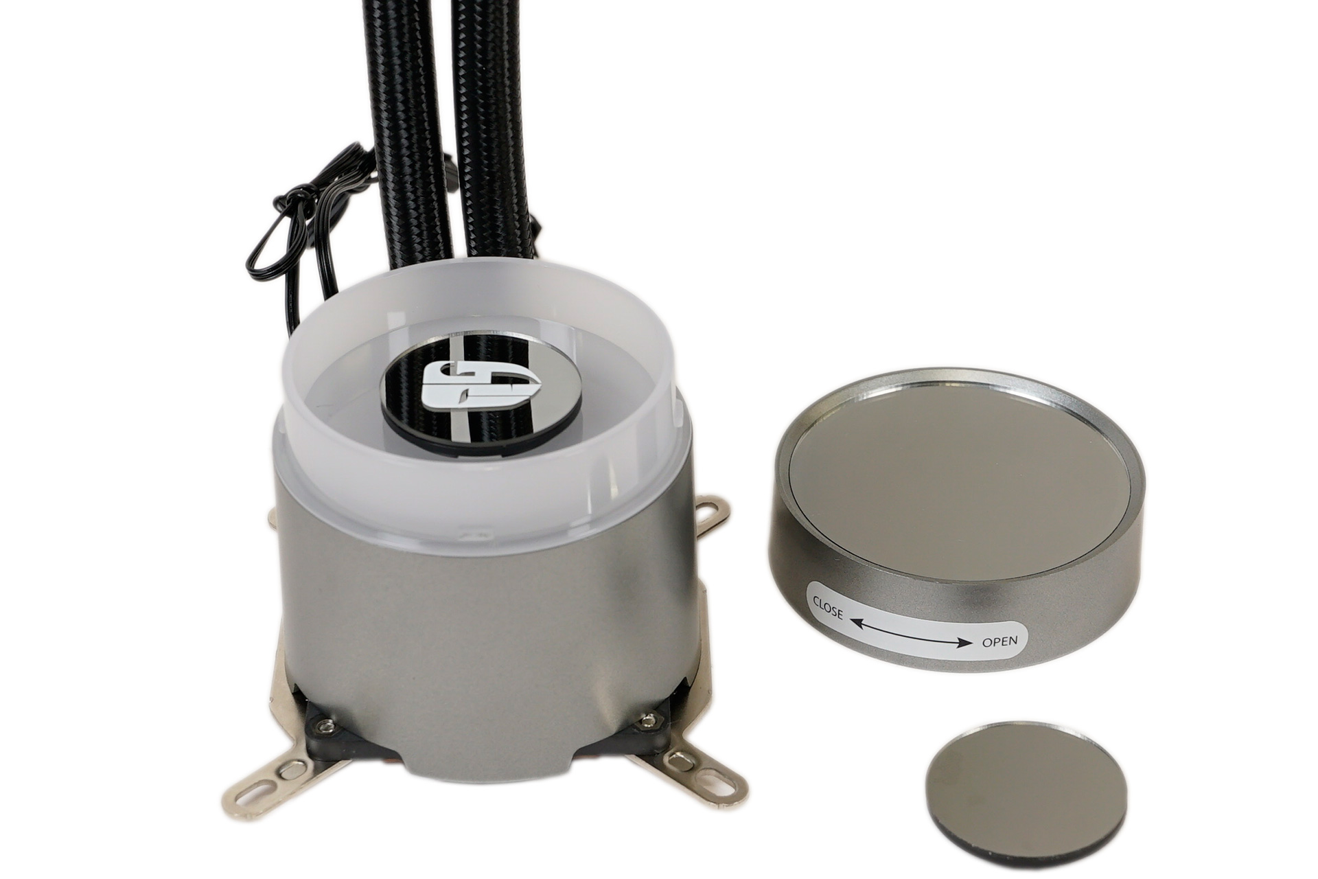

Another aesthetic design tweak is the removable logo cap inside. The top simply twists off, and the logo cap can then be popped out easily. The default Gamer Storm one can be swapped to a supplied blank one which you can customise should you wish. It’s also handy that the design allows for rotation so you can match it to the cooler’s orientation.
