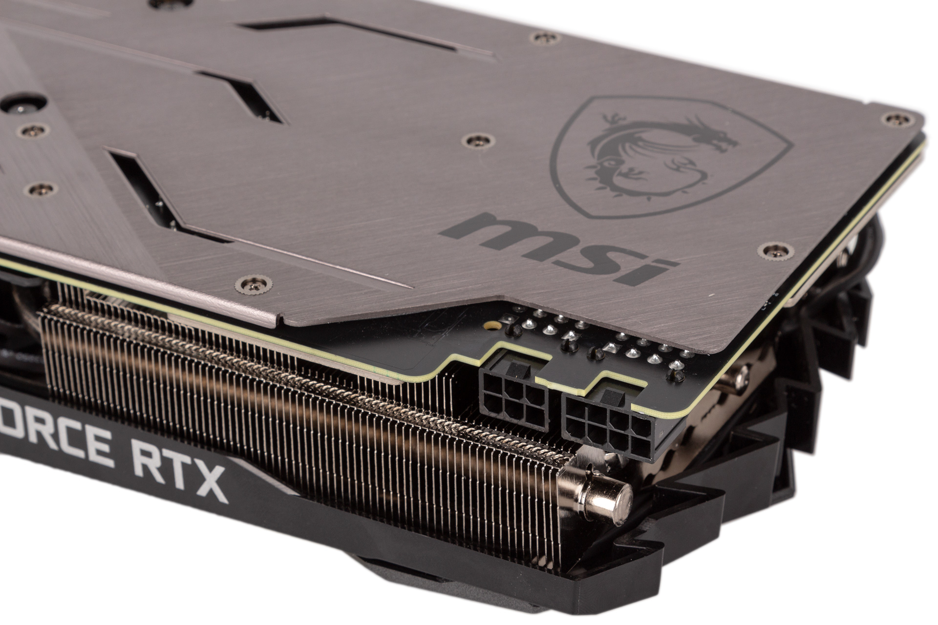

In fairness to MSI, the added stress from the extra power is handled excellently by the Twin Frozr VII cooler. The GPU clock speed remained fixed at 1,920MHz under sustained load with voltage and power listed as the performance cap – not thermals. The fans spin at different speeds, but both were comfortably sub-1,500 RPM, meaning the card was very quiet indeed. All this while maintaining a very cool delta T of just 42°C – cooling performance here is undeniably great.

Regarding the RTX 2070 Gaming Z specifically, MSI has done little wrong. While the overclock is perhaps a little underwhelming in terms of how much benefit it offers, fact is that MSI is pushing the TU106-400A GPU almost to its limit, as evidenced by how little extra is available to squeeze out of it. This certainly isn’t a token overclock, and while it does make for added strain in the form of power and heat, the Twin Frozr VII cooling solution is really excellent, delivering the dream combination of low temperatures, low noise, and zero throttling. The RGB lighting is bold and bright, and the metal backplate and anti-sag bracket make for a well-rounded third-party offering with plenty of bells and whistles suitable for a flagship offering. However, as a result, this isn’t a card that emerges that strong on a price-performance metric. Obviously, it wasn't really designed to, but it's worth noting nonetheless.
